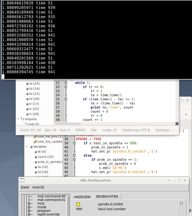

Did some new entrys in the axisui user_command_file today, with some (for me) useful additions:
-Clear the Info notifications, if 5 items reached. Leaving the Alerts untouched. It was hiding some important area of my PYVCP sidepanel when the stack of messages was rising.
-Automatic spindle inhibit when probe is in spindle, and set S0 M5. As any input of S and M3 M4 while inhibited, spindle will instantly start, after spindle.0.inhibit is set false.
Interresting, when a pyvcp panel is in the configuration and a halpin is created in the usercommand file, eg. 'comp.newpin("tch", hal.HAL_BIT, hal.HAL_IN)' after a long search i found it as 'pyvcp.tch'
It made me also think about the polling cycles, compare 'user_live_update()' and a userspace Python component with 'time.sleep(0.001). The results are average 51 or 941 cycles / second on my machine.
prob_in_spindle = 0
def user_live_update():
global prob_in_spindle
#PROB_S0
#PROBE = T999
if s.tool_in_spindle == 999:
prob_in_spindle = 1
hal.set_p('spindle.0.inhibit','1')
else:
if prob_in_spindle == 1:
prob_in_spindle = 0
hal.set_p('spindle.0.inhibit','0')#Clear INFO notifications if >= 5 reached
if len(notifications.widgets) >= 5:
hal.set_p('axisui.notifications-clear-info','1')
else:
hal.set_p('axisui.notifications-clear-info','0')It made me also think about the polling cycles, compare 'user_live_update()' and a userspace Python component with 'time.sleep(0.001). The results are average 51 or 941 cycles / second on my machine.

31 Dec 2020 12:50 #193641
by MaHa
Replied by MaHa on topic Spindle inhibit while probing
Thanks for reply, i will try this later on the machine.
Tried to solve the silly idea, inserting a mdi command in usercommand file, just to run into another problem. I think i will close the workshop for the rest of this year...
