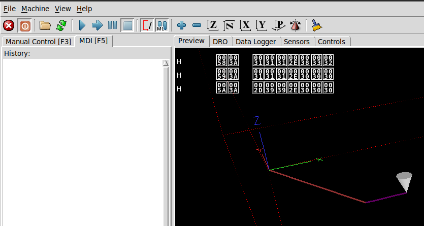

Hello LinuxCNC community
First time poster/ 2 day old linuxcnc user
Since my installation my coordinate position display on the preview tab has looked weird, meaning different from my boss. Please see the attached image.
I primarily used this guide
I'm on a Ubuntu 20.04, and have linuxcnc-uspace version 1:2.8.1.44.g60f3d7
The numbers change in accordance to the machines position, however the small boxes give me no readable information about the actual coordinates. So far I have turned to the DRO tab for that, however I would like to have decimal numbers there instead of the boxes.
What should i do?
Thanks in advance.

Replied by tommylight on topic Weird coordinate position display
Can not recall what exactly, but that has to do with localisations, so try to set locale to UTF8.

My system locale is already set to UTF-8, or is it in linuxcnc the locale has to be set? If so, where can i do that?

Replied by andypugh on topic Weird coordinate position display
The issue, and a possible solution, is described here:
github.com/LinuxCNC/linuxcnc/issues/659

Replied by Stormholt on topic Weird coordinate position display
Thank you very much !
