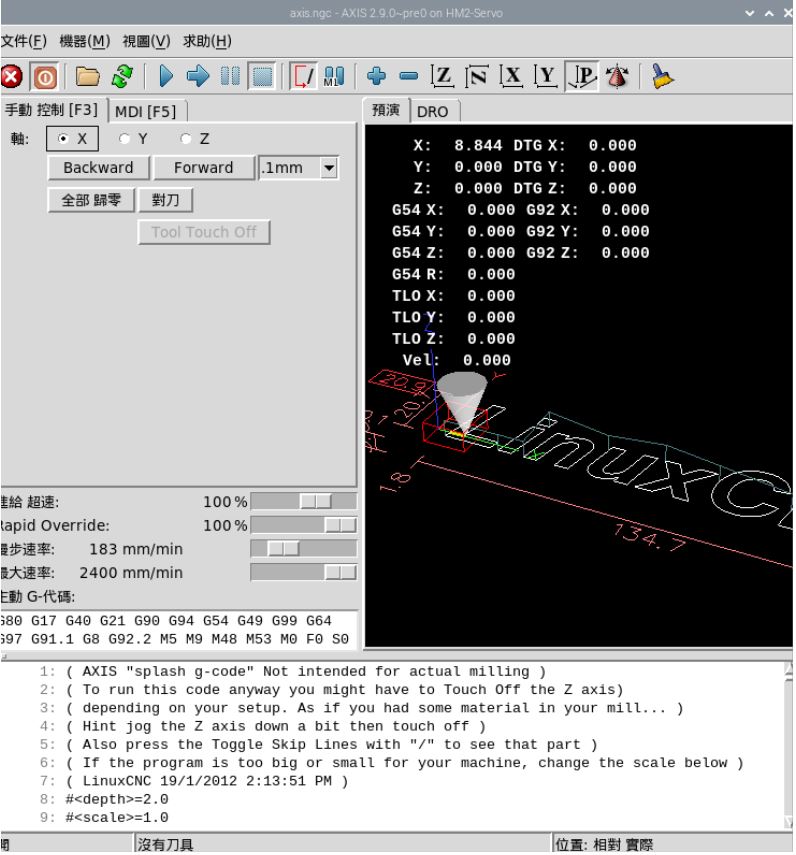

I need an external signal to control the X axis forward and backward,
I use linuxcnc.org/docs/html/man/man9/motion.9.html#AXIS%20PINS ,but it any action
how to jog work for hal
thank
thank

I am fairly new to LinuxCNC,the code How to use ,I need to one clack to forward or backward

use halui to hal or ini ?
thank
Replied by Jialan on topic How does jogging work?
I want to use check code(.hal 39row) to control motor
thank
