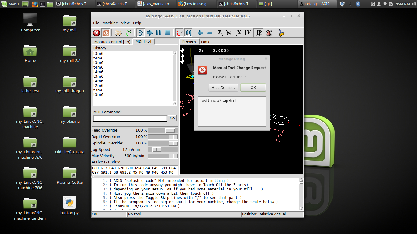

So I started using the probe screen
here
a few months ago, and the probe screen is working well, but the tool length setter was giving me troubles. A friend wrote a few files which seemed to make the tool length setter work well, but he wrote it for gmoccapy, since that's what he uses. I know the probe screen files originally used something that looked identical to the gmoccapy tool change pop up (with the tool number and the tool description), but i'm not sure how it did that. in his HAL files for gmoccapy, he calls something like this
and in order to get the tool length setter working in axis i have to call something like this, because if i try to use the above, it gives an error saying it can't find gmoccapy or something similar
So i guess long question short... does anyone know how to use the gmoccapy tool change pop up in the axis screen? having that tool description would be really nice to have. I know it's possible, since the probe screen originally had it, but I'm not sure how to get it back. Thanks a bunch!
net tool-change gmoccapy.toolchange-change <= iocontrol.0.tool-change
net tool-changed gmoccapy.toolchange-changed <= iocontrol.0.tool-changed
net tool-number gmoccapy.toolchange-number <= iocontrol.0.tool-prep-number
net tool-prepare-loopback iocontrol.0.tool-prepare <= iocontrol.0.tool-preparedand in order to get the tool length setter working in axis i have to call something like this, because if i try to use the above, it gives an error saying it can't find gmoccapy or something similar
net tool-change iocontrol.0.tool-change => hal_manualtoolchange.change
net tool-changed iocontrol.0.tool-changed <= hal_manualtoolchange.changed
net tool-prepare-loopback iocontrol.0.tool-prepare => iocontrol.0.tool-preparedSo i guess long question short... does anyone know how to use the gmoccapy tool change pop up in the axis screen? having that tool description would be really nice to have. I know it's possible, since the probe screen originally had it, but I'm not sure how to get it back. Thanks a bunch!

I guess that's what was done already in the probe screen that i was using then, as i was using the probe screen (the default tab name for it is PSNG) with axis. when an M6 command would pop up, even if i had unselected to do the M6 remap on the probe screen, it would still pop up a dialog with the tool description and number, to what i thought was identical to the gmoccapy one. I'm just not sure which portions of the probe screen manual tool change is used to call out to this other dialog popup. If i can figure out which portions are used to call the nice dialog tool change popup, then I could probably copy and paste things around a bit to use, instead of the default axis one... I'm just not sure where to start looking is all.

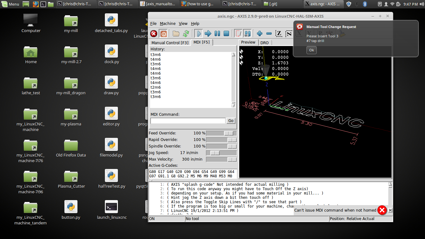

could you post a pic of the dialog so we know what you are referring to?

Sure,This is the dialog I'm trying to get to pop up, or really anything similar what would also have the tool description in it

Axis has such a popup for toolchange, and there is an entry for manual toolchange prompt in the PncConf, not sure about StepConf though.
