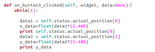

Excuse me, why can't I get the position of the axis in other functions using Python script? Why? Is there any good solution?

I am not 100% sure what your self.status is but if it is linuxcnc.stat() then you need to poll it to get an update:
self.status.poll()Please Log in or Create an account to join the conversation.

Hello, thank you very much for your reply, but isn't my while (1) polling him? What do you mean by self. Status. Poll (), can you elaborate?

You need to poll linuxcnc.stat() periodically to read the state:
linuxcnc.org/docs/devel/html/config/pyth...ding_linuxcnc_status
You may be better of using GStat:
linuxcnc.org/docs/devel/html/gui/GStat.html
