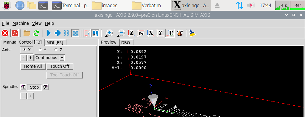

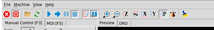

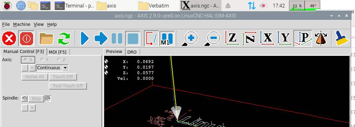

I have to use windows at work, and those stupid flat minimalist icons are starting to grow on me slowly. Axis menu bar is kinda like the ribbon,and the buttons were alrerady pretty minimal with an aesthetic I like, so I though Id flatten them up a bit, since Im already here, I might as well embiggin them a bit too(just simple scale, nothing fancy)I changes a few buttons a little. There may be something like this already but I had something in mind I wanted to do.
Now I have a question,
How do I get the names under the buttons?
I thought that was an option but I cannot find it anywhere, and I though I saw a screen cap recently of someone else with it on but i dont know anymor... If its not an existing option its not a problem, usercommand will take care of that, but if its an option id rather use that. like "axis_big" or something

Replied by tommylight on topic Axis Menu Icons - Flat and minimal (sometimes big)
forum.linuxcnc.org/21-axis/29735-axis-modifications
and the new link for 2.8
linuxcnc.org/docs/2.8/html/gui/axis.html#_axisrc
and
forum.linuxcnc.org/21-axis/16426-changin...the-axis-gui?start=0
Maybe it helps ...

Another question, what is this icon for "tool_verify"

I asked Jeff:
"It can safely be deleted.
It's possible to have task run the gcode interpreter in "verify" mode to find syntax errors. this was used by many of the older UIs. It's not as useful in AXIS because the errors should be detected during preview generation.
If the button did exist basically it would make task run through the whole part program as fast as possible, and report any errors (such as bad gcode syntax, soft limit exceeded, etc) to the UI"
