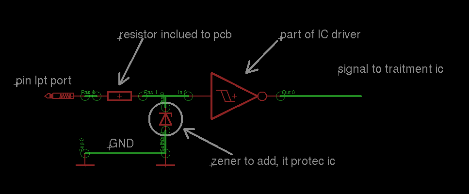

- fgh3040
- Posts: 5
19 Oct 2021 09:31 - 19 Oct 2021 09:32 #223539
by fgh3040
Replied by fgh3040 on topic jogging Z axis during execution
Hello Billykid
My hardware is cnc3040 or cnc3040t (i don't know exactly)
I've buyed it in 2012, and contrôller is linked to a parrallel port (lpt)
To use autoleveller software i use pin13 of my lpt port (i think) and ofile:///home/fgh66/Bureau/zener5V6protect.png
ther pin exept pin used for 3 axis machine are free.
Spindle motor are www.amazon.fr/VEVOR-Refroidissement-Vite...1112892&sr=8-22&th=1
Tip : to protect your hardware you can add a zener diode with voltage 5V6.
Connect it to input pin ic, after resistor connected at input of ic and gnd.
Look at attachment.
Look at attachment.
