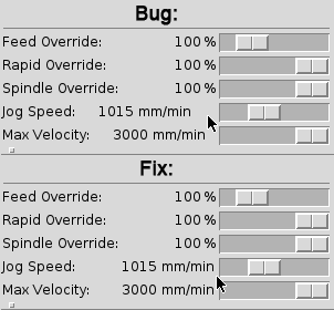

I made a little fix for Axis interface:
axis.tcl:
axis.tcl:
Orig:
pack ${pane_top}.ajogspeed.l0 -side left
pack ${pane_top}.ajogspeed.l -side left
pack ${pane_top}.ajogspeed.l1 -side left
pack ${pane_top}.ajogspeed.s -side right
pack ${pane_top}.jogspeed.l0 -side left
pack ${pane_top}.jogspeed.l -side left
pack ${pane_top}.jogspeed.l1 -side left
pack ${pane_top}.jogspeed.s -side right
pack ${pane_top}.maxvel.l0 -side left
pack ${pane_top}.maxvel.l -side left
pack ${pane_top}.maxvel.l1 -side left
pack ${pane_top}.maxvel.s -side right
Fix:
pack ${pane_top}.ajogspeed.l1 -side right
pack ${pane_top}.ajogspeed.l -side right
pack ${pane_top}.jogspeed.l1 -side right
pack ${pane_top}.jogspeed.l -side right
pack ${pane_top}.maxvel.l1 -side right
pack ${pane_top}.maxvel.l -side rightAttachments:

Replied by andypugh on topic Small fix for axis.tcl
Are you able to make a pull request on GitHub?
(Fir a single file change like this you can make the edit live in the web site. But you would have to register )

by D.L.
Replied by D.L. on topic Small fix for axis.tcl
I did it: github.com/LinuxCNC/linuxcnc/pull/1387
and for 2.7 and 2.8
and for 2.7 and 2.8
