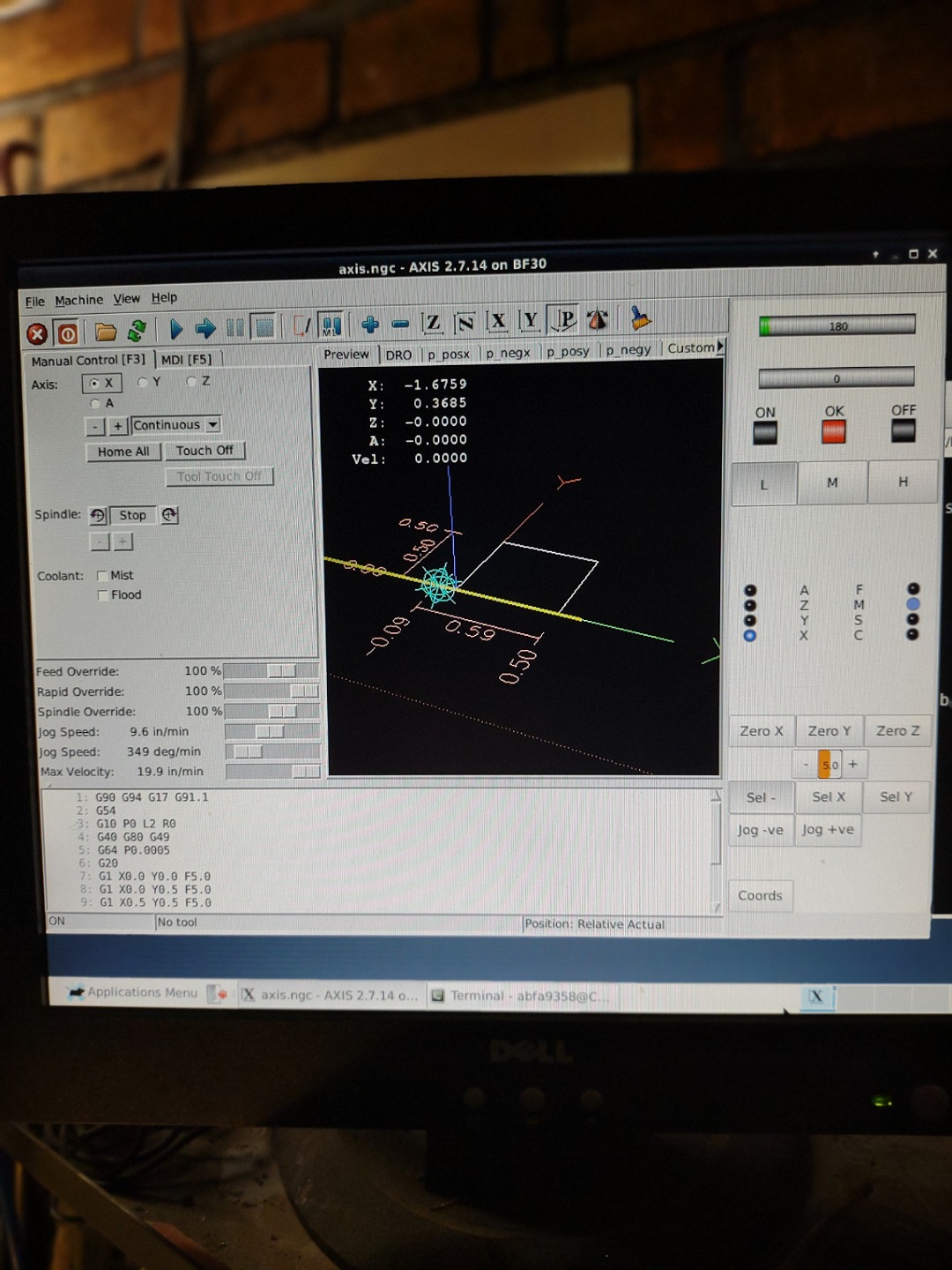

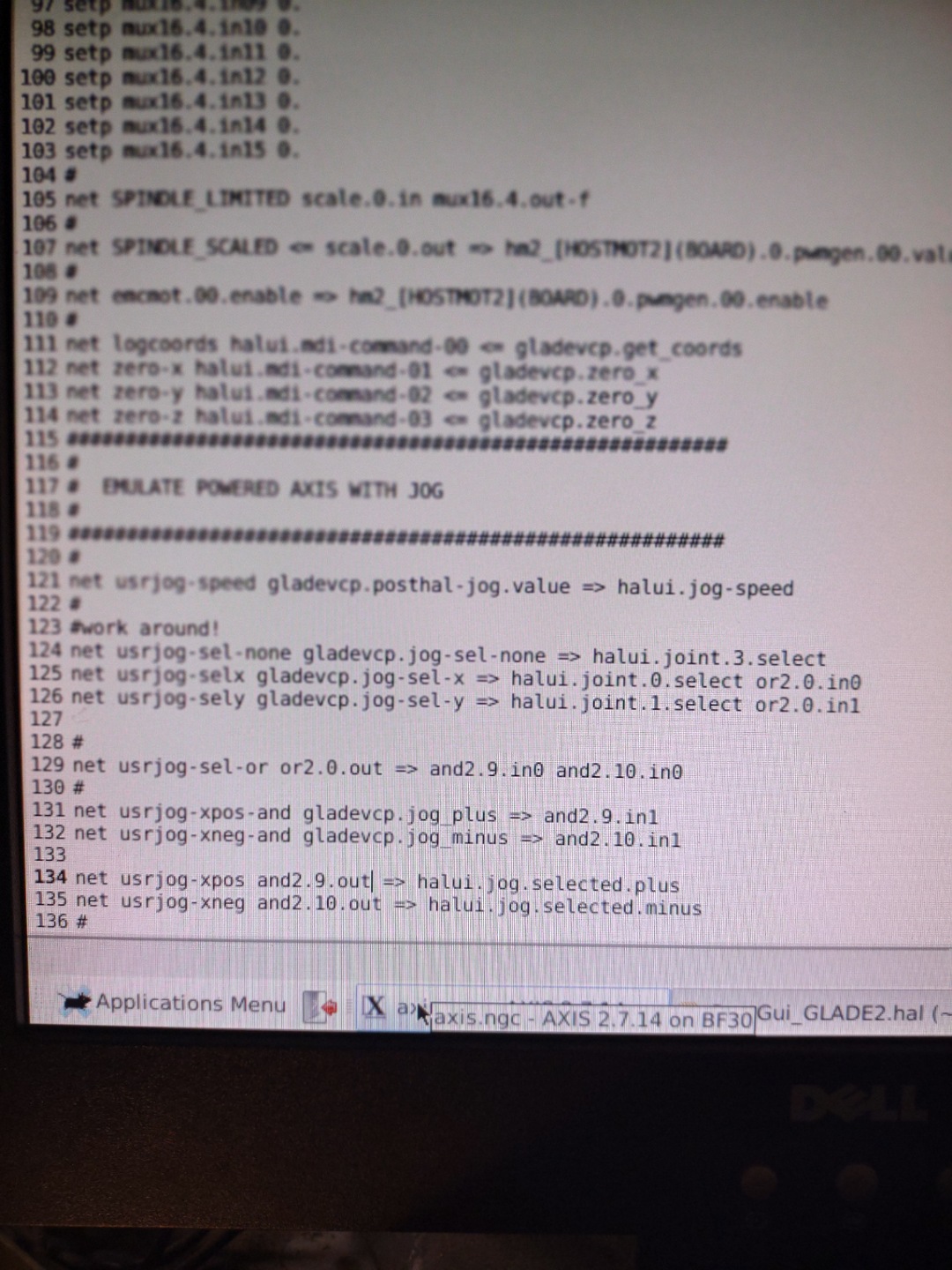

I finally got this working the way I wanted it to work for my very specific context. I created some buttons and then connected them via the HAL to joint jog and select pins. I added a speed control linked to the jog speed pin
