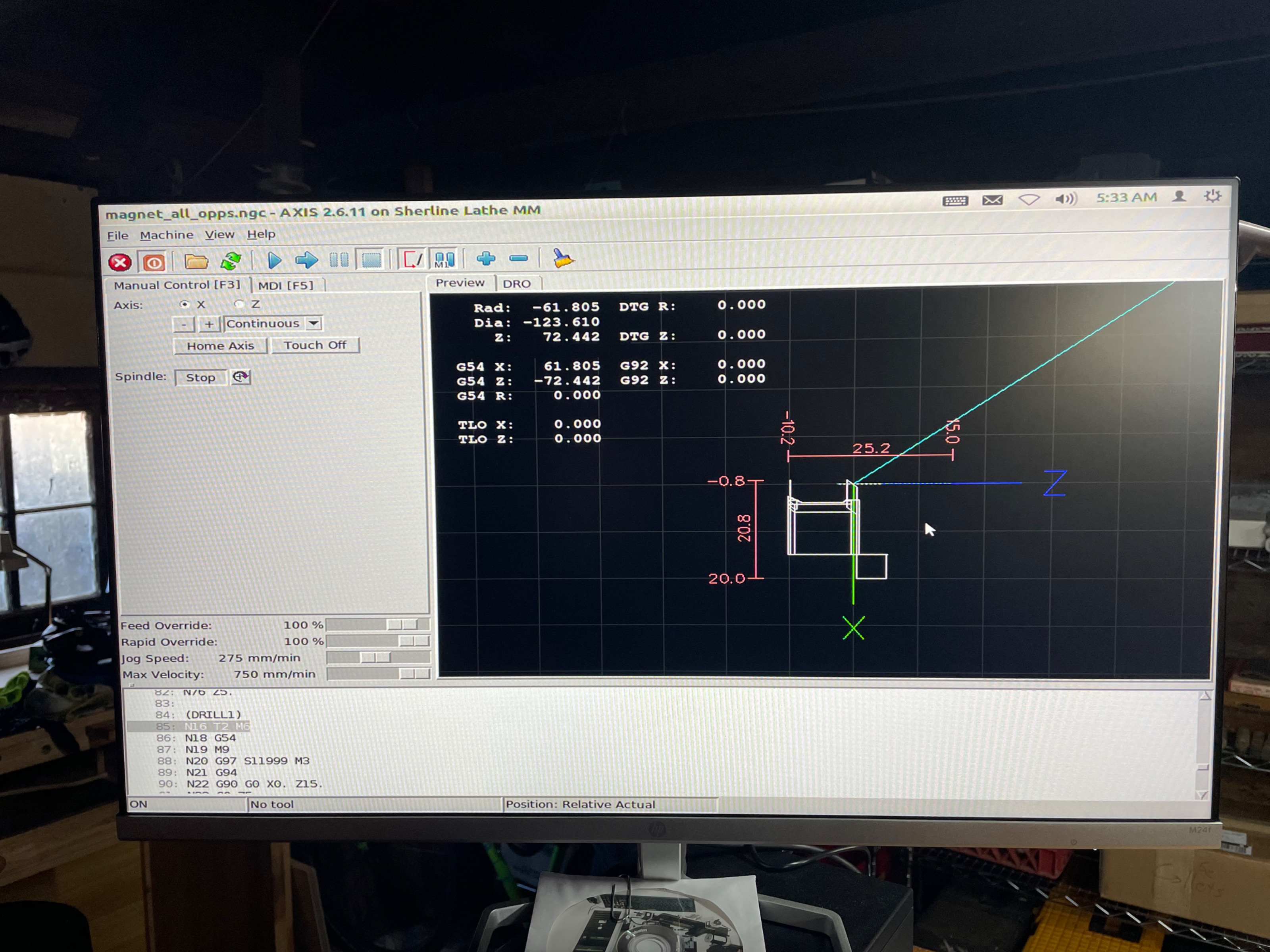

Setting up my first CNC lathe, I bought a Sherline 4410 system. I have successfully setup and run a program that uses just one tool. Now I am trying to setup a gang tooling program. I watched a bunch of videos of others and noticed that most of not all had a “Tool Touch Off” button just below the “Touch Off” button in Axis. I am running version 2.6.11. And I will attach a screenshot.
Is there a setting or config I need to do to make this “Tool Touch Off” button appear? Or is there a different approach to this in my version of Axis?
Thanks for any help. I couldn’t have gotten this far without reading dozens of other posts in this forum.

The separate button did not exist in version 2.6 (released 2014)
The equivalent functionality is there by picking "tool table" in the drop-down in the dialog box.

Maybe I am interpreting it wrong, but this statement in section 1, from this link you suggested above: linuxcnc.org/docs/2.8/html/getting-start...dating-linuxcnc.html
“Furthermore, if you are running Ubuntu Precise or Debian Wheezy it is well worth considering making a backup of the "linuxcnc" directory on removeable media and performing a clean install of a newer OS and LinuxCNC version as these releases were EOL in 2017 and 2018 respectively.”
But if the Tool Touch Off button was added in v2.7, then I am hopeful that helps me accomplish what I am wanting to.
I also reached out to Sherline to get their thoughts and this is what they responded with:
“The version of ubuntu/linuxcnc 2.6.11 is the most stable version for across the board compatible with most hardware in today's computers (video chip,bios)note: 1 As far as the OS (ubuntu VS  Debian 7 Wheezy)  there is no major advantageas for network connection or major computer componets.as we have tested Debain and it can be unstable for our use. It may be ok for one person (DIY)
2.linuxcnc most of the upgrades from 2.6.11(with OS ubuntu to linuxcnc 2.8 with OS debain) have had bug fixes.However, they are not useful upgrades for running our machine. They may have added a subroutine or caned cycle that is not unstable for our machine operations.As you can see below(from linuxcnc.org) both of the below the statment (very often more than good enough)is not good enough for mass production remember that these systems are open source  and as you see A lot of these upgrades are  for hardware that we dont use as you see in section linuxCNC 2.7 highlighted in redWe have tested newer verison of linuxcnc and the OS needed and found even though there are newer versions, they either have bugs, they are not compatible with our hardware, or the upgrades are for functions that we don’t use or need.”
So at the moment I feel like my best path is trying to figure out how to achieve my goal of touching off multiple tools with the current version.
Which brings me to something you mentioned above.
“The equivalent functionality is there by picking "tool table" in the drop-down in the dialog box.”
Any chance you could expand on that. I know how to get to the Tool Table but once there I am not sure how to touch each tool off.
