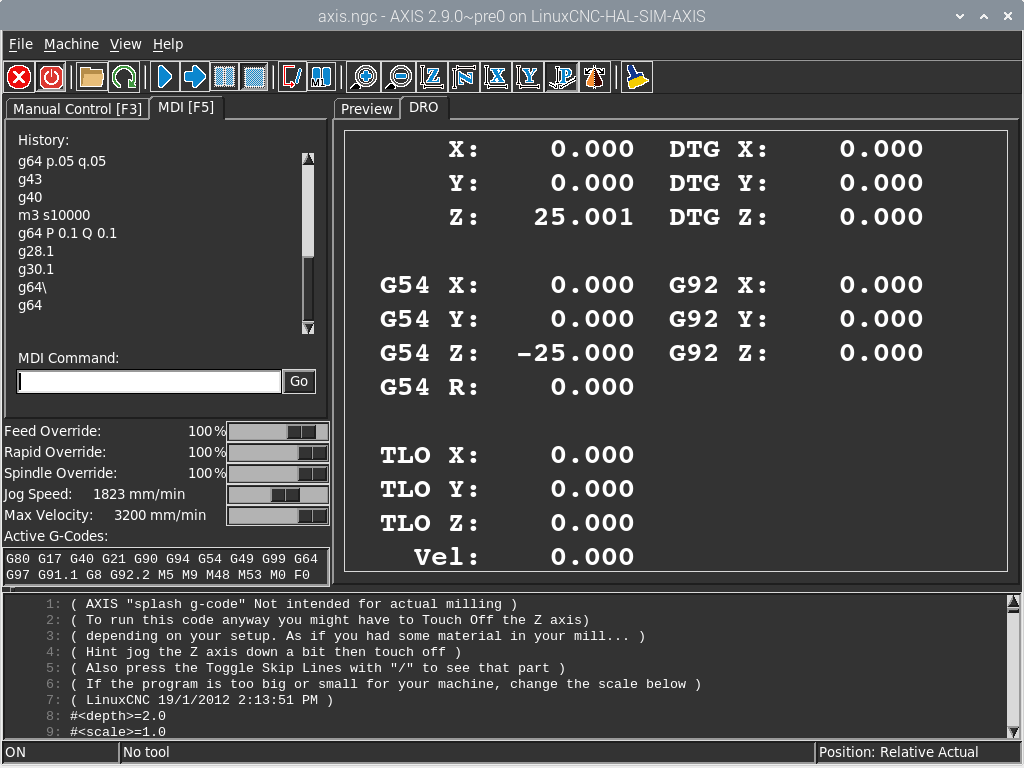

I modify my axis config in dark mode. If anyone wants too, here is the config.
Save this config in folder /usr/share/axis/tcl/
rename file axis.tcl -> axis.tcl.bak and rename new config to axis.tcl
for future color change, rename variable "grey20" to your choice.
Color list
www.tcl.tk/man/tcl/TkCmd/colors.html
should work for 2.8 and 2.9 Version

I'm glad someone liked my changes.
Kinda wish a darker theme option was defualt option or a much easier way to swap to it.

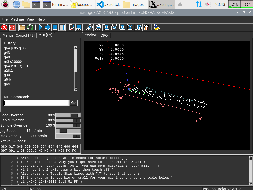

usercommand version, got most of itor a much easier way to swap to it.
[DISPLAY]
USER_COMMAND_FILE = usercommand_dark.py

I made some bigger icons for my 24" 1920 X 1080 touchscreen called them the same names as PNG files scaled from svgs as a quick fix.

no problem. since everything is now broken out in this usercommand file, it should be a lot easier to configure other parts of axis as you wish. like making the buttons different sizes or changing their function, and with some computer hacking and inspiration from plasmac axis you could probably change them all with variables or use the colour selector widget

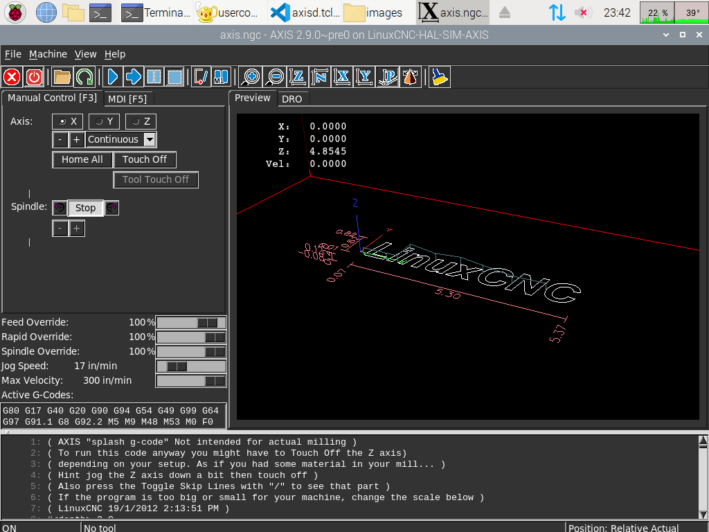

if you wanna mess around with the usercommand file (i recommend it over using axis.py or axis.tcl if you can avoid it) , here is some sample code I use for my touch screen endeavors, but my screen is much smaller at 800x480, but the ideas are the same, bigger scrolls, sliders and buttons
########### BUTTONS ###########
#estop button
W(".toolbar.machine_estop","configure"
,"-text","ESTOP"
,"-activebackground","red"
,"-background","red"
,"-helptext","Toggle Emergency Stop [F1]"
,"-font","mono 10 "
,"-compound","top"
,"-width","26"
,"-relief","flat"
##### configure sliders #######
W('.pane.top.feedoverride.foscale','configure','-resolution','10','-length','170','-width','20')
W('.pane.top.spinoverride.foscale','configure','-resolution','10','-length','170','-width','20','-sliderrelief','flat','-troughcolor','lightgray','-background','darkblue','-foreground','lightgray')
W('.pane.top.rapidoverride.foscale','configure','-resolution','10','-length','170','-width','20')
W('.pane.top.jogspeed.s','configure','-length','170','-width','20','-sliderrelief','flat','-troughcolor','lightgray','-background','darkblue','-foreground','lightgray')##########################
######### config scroll bars #########
W('.pane.bottom.t.sb','configure','-relief','flat','-troughcolor','grey30','-background','grey90','-width','20','-elementborderwidth','1')
########### configure tabs #################
W('.pane.top.right','configure','-arcradius','8','-font','mono 12')
W('.pane.top.tabs','configure','-arcradius','8','-font','mono 12')

the spindle CW and CCW / M3/M4 buttons were the first I changed to something touchable
