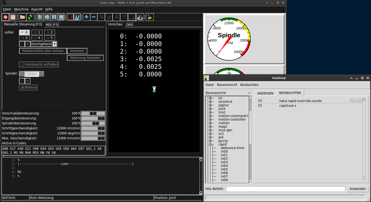

I have a small issue after update to 2.9.
After startup, my rapid feed value is always 100%. Doesn't matter of switch position. It is a 4 bit rotary switch and connect to a mesa 7i84 board and this connect with sserial to 7i76e.
I had the same issue on 2.8. But after loaded the mpg.hal over the postgui_call_list.hal, swapped the federate after 1 second to the switch value and the problem was solved.
But now in 2.9.? No Idea
I check the value of halui.rapid-override.counts and value is 25% switch is on 25% position too. But in Axis is rapid feed override 100%. Same issue with feed override.
Had someone same issue or an idea how to fix it?

What is different? I already use the
mux_generic config="ss32" function.
Why switch your feedrate after emg release?

- chris@cnc
- Posts: 529
- Thank you received: 140
03 Apr 2022 15:56 #239185
by chris@cnc
Replied by chris@cnc on topic Wrong rapid feed control during startup
i see, you switch one time after power on.
net machine-is-on mux-gen.00.sel-bit-00
If i do it same way i can not select all values.
So i need one bit that toggle the mux-gen.00.sel-bit-00 one time after start up...

03 Apr 2022 17:09 #239194
by chris@cnc
Thanks anyway for your help. I looked in the magic bag and found something suitable.
linuxcnc.org/docs/stable/html/man/man9/oneshot.9.html
This does exactly what I wanted.
Touch other selection bit short time.
I'm always amazed at what's in this bag. Many thanks to the developers..
loadrt oneshot
addf oneshot.0 servo-thread
setp oneshot.0.width 1 #one second pulse
net machine-is-enabled oneshot.0.in
net rapid-bit3 <= oneshot.0.out => rapid.sel3 #switch one second after machine is enabled

03 Apr 2022 18:26 #239197
by chris@cnc
Yes, to simulate a switch movement and read the current value.
The following user(s) said Thank You: roland
