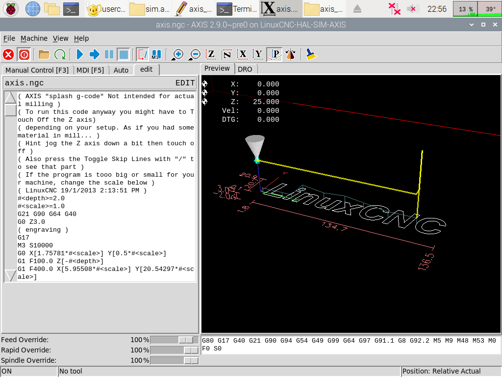

Im sorry this is getting tedious. I really appreciate the help. Well, that probably means I have bigger issues then doesnt it? For reference, Im using a premade RPI image of Buster with a RIP 2.9
Alright if the code works for you and not me, then I guess I have a problem on my end I have to figure out.
I copied that code exactly into a new file, and added rC = root_window.tk.call to the top, and got pretty much the same error

I should have seen this earlier, to run that test script stand alone it requires:
commands = TclCommands(root_window) after the TclCommands...Please Log in or Create an account to join the conversation.

hmm for some reason I didnt copy it over, thats a rookie move on my part. Thanks for the help, that took care of the issue, and it now opens and saves automatically , I added a reload_file() on exit also, so the tab functions pretty well.
It might be pretty basic, but its nice having it right there in the same window. Last major thing on the ol TODO list, is this keybinding. Im pretty sure Ive figured out why keybinds dont happen with entry and they do with text, it was in axis.tcl
I dont 100% understand, but I think it says its binding entry/spinbox, and then it checks state, and then breaks the keybind. Im assuming this only breaks keybind when the widget is in focus?

I am very close on the binding. by close I mean usable. I am on the key binding section, I started with the letter keys (I think), and will work my way through the rest.
I almost understand it all, but the last part still eludes me, but I think this is the one I want.
The problem - Keybindngs apply to all widgets except for entry and spinbox, as per this section of axis.tcl as far as i understand.
github.com/LinuxCNC/linuxcnc/blob/master...s/tcl/axis.tcl#L1997
What I think this section does, it send break to the binding event to stop it from happening. and then something does something to make the keystrokes work normally. because once I send break to the bind, all key strokes do nothing anymore withing the text widget. O does not open file, but it does not "o" either.
I think that is this section right here,
my understanding of it is, bind key, check if( state of the widget is normal) and [string length %A], then break
I see %A means www.tcl.tk/man/tcl/TkCmd/bind.html#M42
it means/turns keybind events into the corresponding unicode character...... something something. thats where im stuck
edit, and also, bug, if you open a file with the edit tab open, it will not update and over write current file with the old file....I need to...compare something....or something....

Phil, thank you for all the help
, I have a pretty usable editor with minimal bugs. I dont know yet how to keep the gcode files in sync between axis and the editor, so dont open a file with the editor tab open, or it will over write it with the previous file. or undo too many times.
There was no pretty way to do the keybinding.
