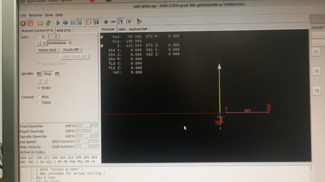

The Z axis does not move on the preview screenI have a problem with the GUI AXIS, it is from a lathe, on the preview screen when I physically move the Z axis this axis moves normally but on the screen it always stays in the initial position. I append the hal and INI files

In the INI file, try GEOMETRY = xz instead of GEOMETRY = xy

That GEOMETRY setting line is in the [DISPLAY] section of your ini file.
