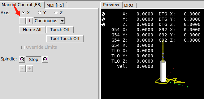

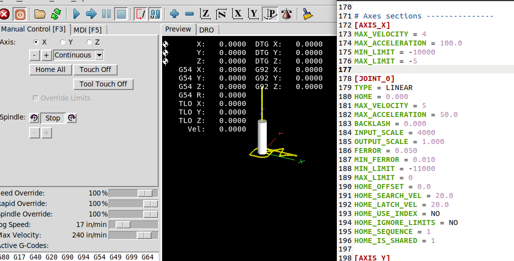

I am sorry for my unclear expression. I will give an example. The [AXIS_X] MAX_LIMIT is -5 and the [JOINT_0] (which is belong to axis_x)MAX_LIMIT = -2. I have made it homed by modifying the code like the first picture. And then I want to move the axis x into the limit by pin halui.axis.x.minus or the minus sign on the interface (which is shown as the second picture )so that is can work. I think I should modify the code, but I don't know how to do.
