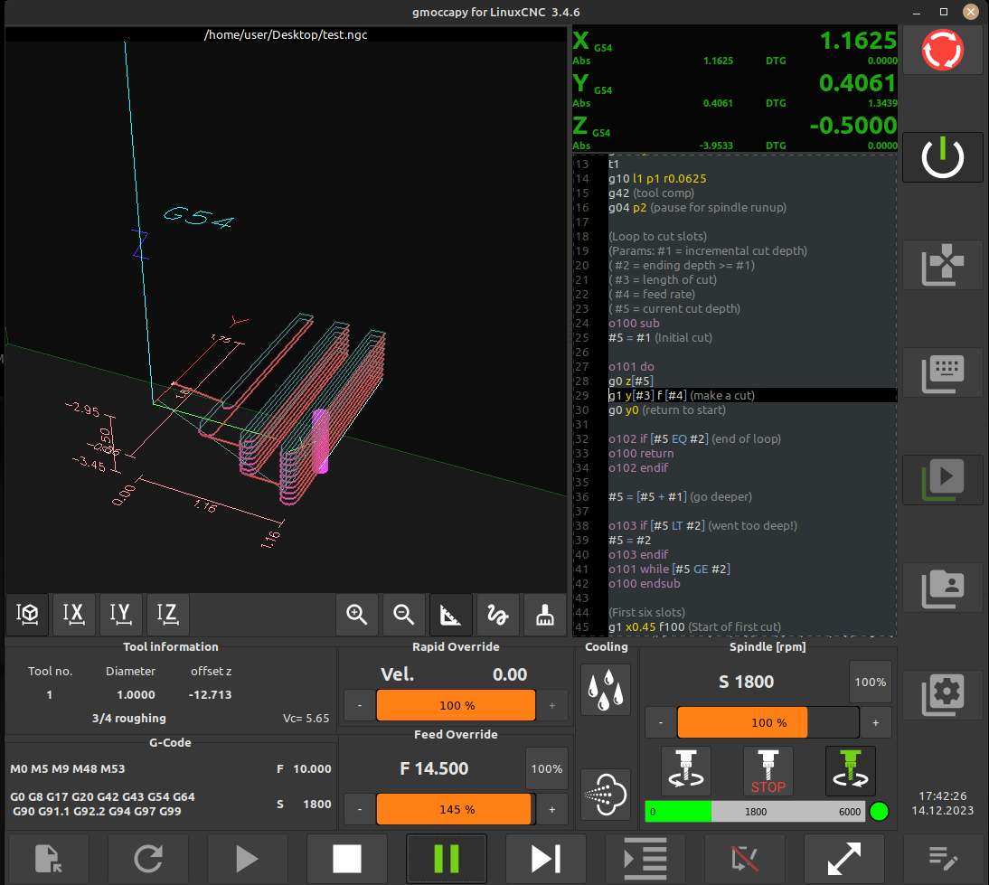

18 Dec 2023 13:36 #288484
by ckuecker
Replied by ckuecker on topic Tool compensation question
Ran the simulation. It runs, but it appears the return path after each cut will blast through material I do not want cut.
The program before compensation had the cutter return at high speed through the slot just machined. The slots are 1/8" wide, and the cutter is 1/8" diameter.
All I want is for the left side of the cutter to follow the left edge of the slot. I still have no idea why the program hangs after starting the spindle.
Maybe I don't actually want to turn on compensation? An offset of 0.0625" might do the job, but I really need to understand how to use compensation for future jobs.

Replied by Aciera on topic Tool compensation question
You have compensation active on the return path as well.
