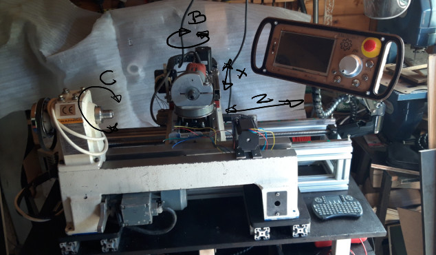

Hello everyone, I'm looking to set the B axis tilt in LinuxCNC, where the B axis is positioned at 90 degrees to the Z axis in a lathe configuration (CXZB).
- I have set GEOMETRY = !CXZB
@++ Jean-Claude
@++ Jean-Claude

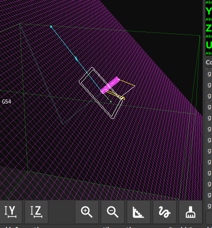

Are you trying to get the physical motor working or are you referring to the screen preview not showing what you expect?

It's just to check the G-Code, I think the engine must be running. I don't have access to the machine at the moment.
@++ Jean Claude
@++ Jean Claude

I'm out of time for today but maybe try:
GEOMETRY = !B!CZX
Note that this feature has bugs regarding the work offsets so I'm not sure how useful that is to you,
GEOMETRY = !B!CZX
