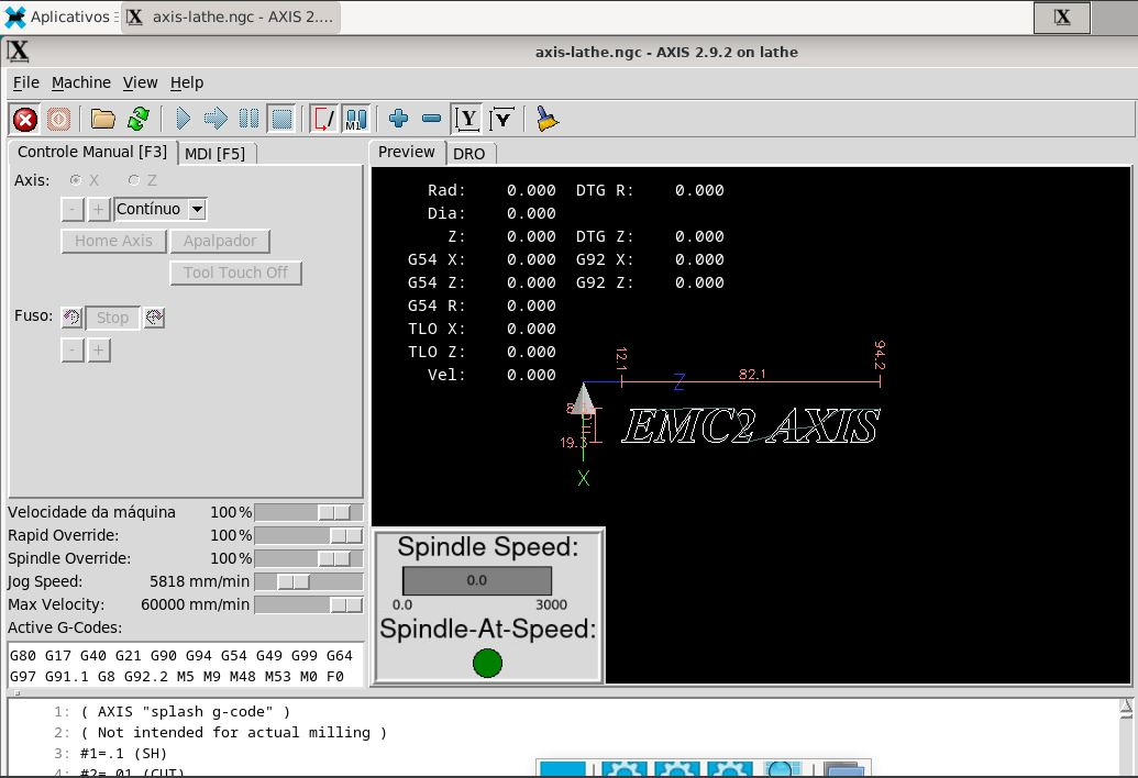

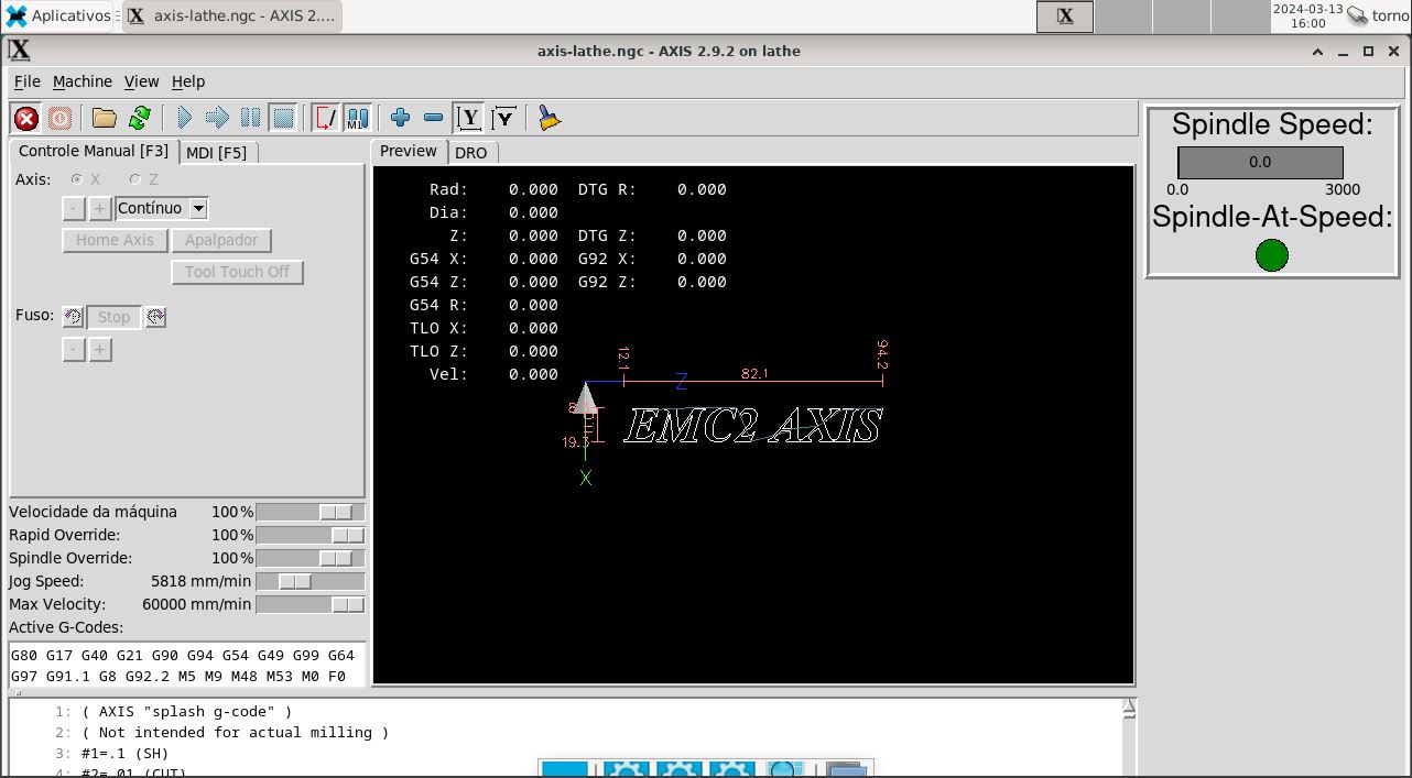

Hello everyone! I'm using the axis ui as the first image, and I'm trying to modify it to look like the second image. Anyone have a clue if that is possible, and how to do it??

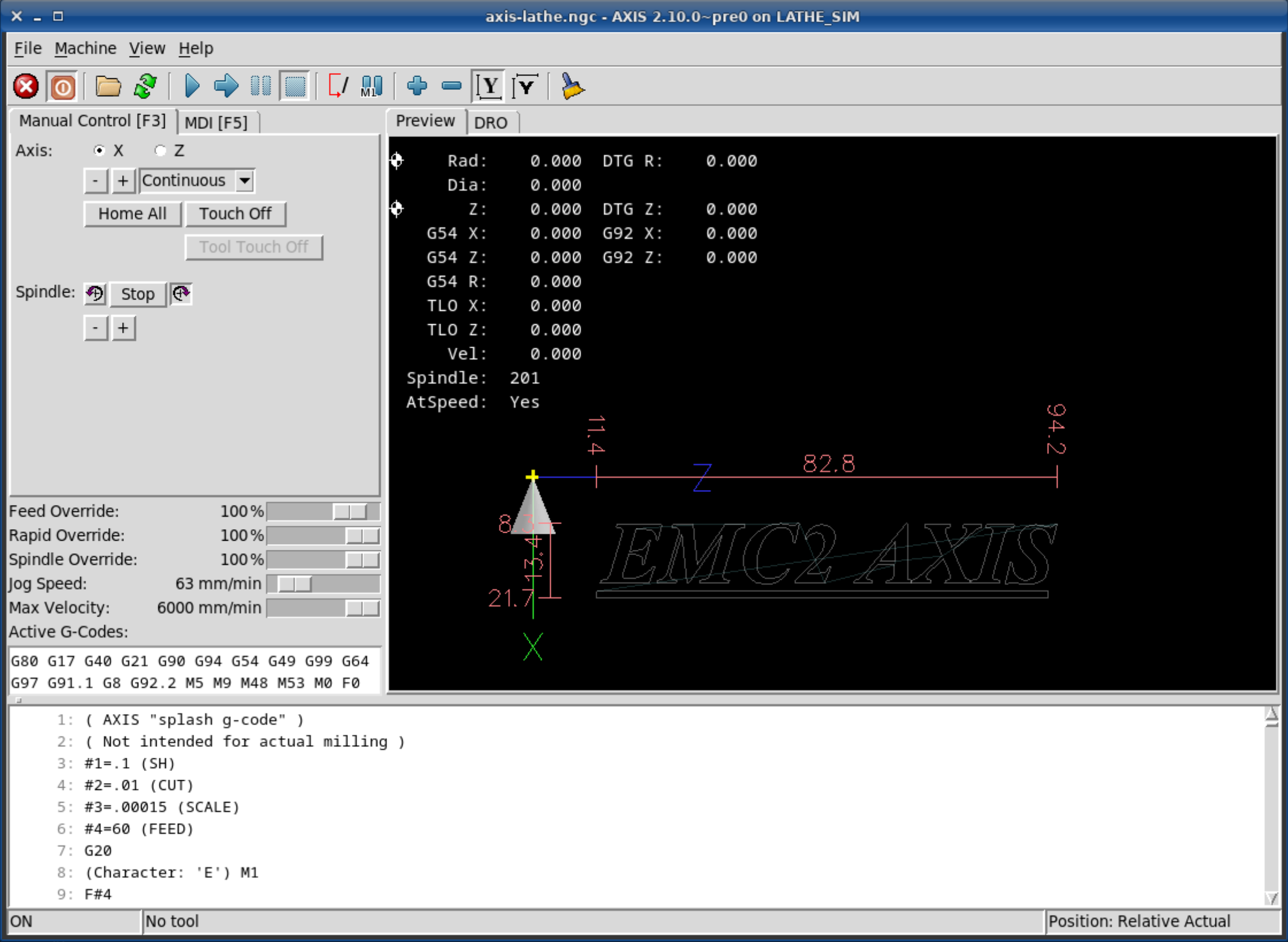

This is not quite what you wanted but is easily obtained by the attached
user_command_file
. It works both with and without "Show offsets" in the "View" menu.

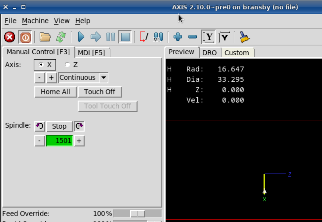

Another option is to add a RPM label to the existing spindle widgets and change it to green when it is at speed:
