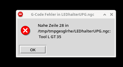

25 Apr 2024 09:30 #299070 by MaHa
Abort produces G-code Error was created by MaHa
In AXIS 2.9.2
If something like   (abort, Tool L GT 35)   is in G-Code, i get an error
So i had to replace abort by MSG, followed by an M0, to run this file.
in MDI i can enter  (abort, Tool L GT 35)  and the message is displayed
26 Apr 2024 07:29 #299110 by MaHa
Replied by MaHa on topic Abort produces G-code Error solvd
If i test for #<_task> the preview works, and abort message is displayed and it is aborting when run program and the abort condition is met.   #<_task> was the solution when used in a subroutine
