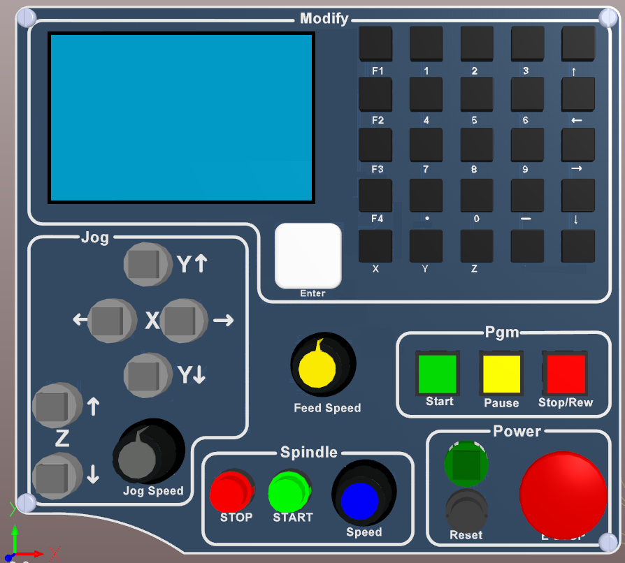

Please critique this control board
- slowpoke
- Posts: 224
- Thank you received: 28
31 Aug 2024 01:39 - 31 Aug 2024 01:39 #309064
by slowpoke
Please critique this control board was created by slowpoke

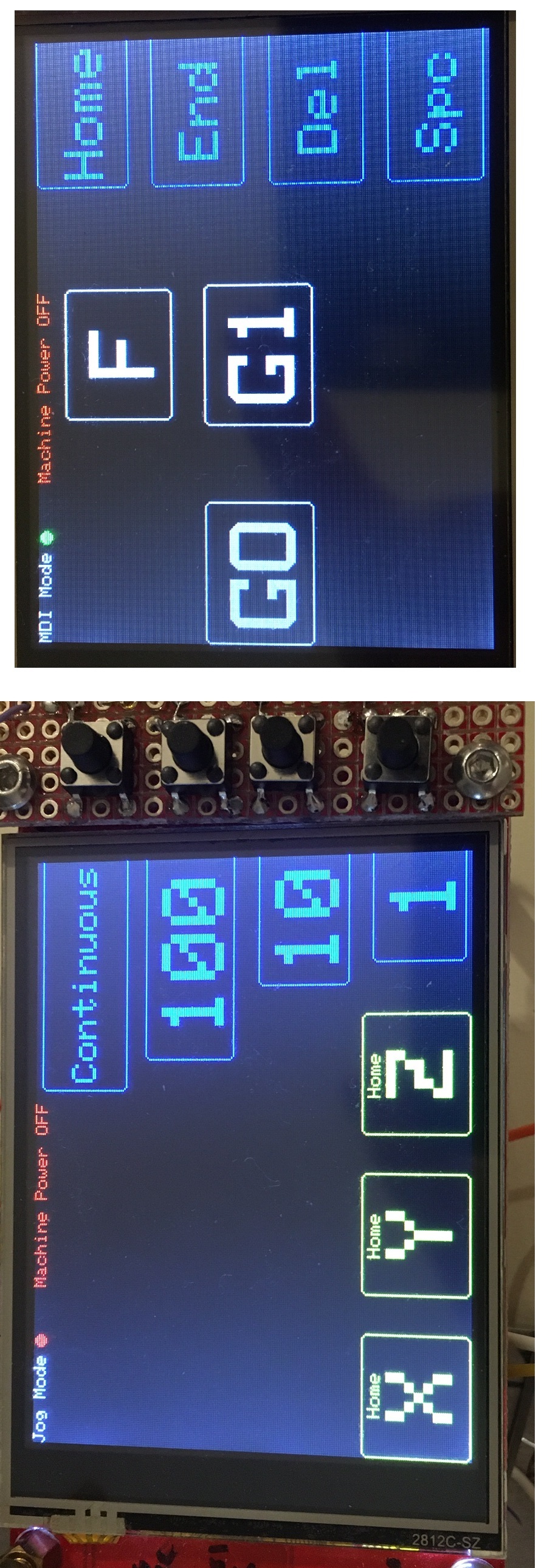

I'm about to order this control board that I will mount to the belt cover of my knee mill. The two black buttons (bottom right) are looking for a feature. So please chime in with "you really need a button for ....." whatever you think I have overlooked.The display (WIP) is capacitive touch-screen and will have several modes Manual, MDI, calculator, etc. with displayed values and additional mode appropriate buttons.

Looks really really good.
Coffee & Beer ?
G0 & G1 ?
Coffee & Beer ?
G0 & G1 ?
