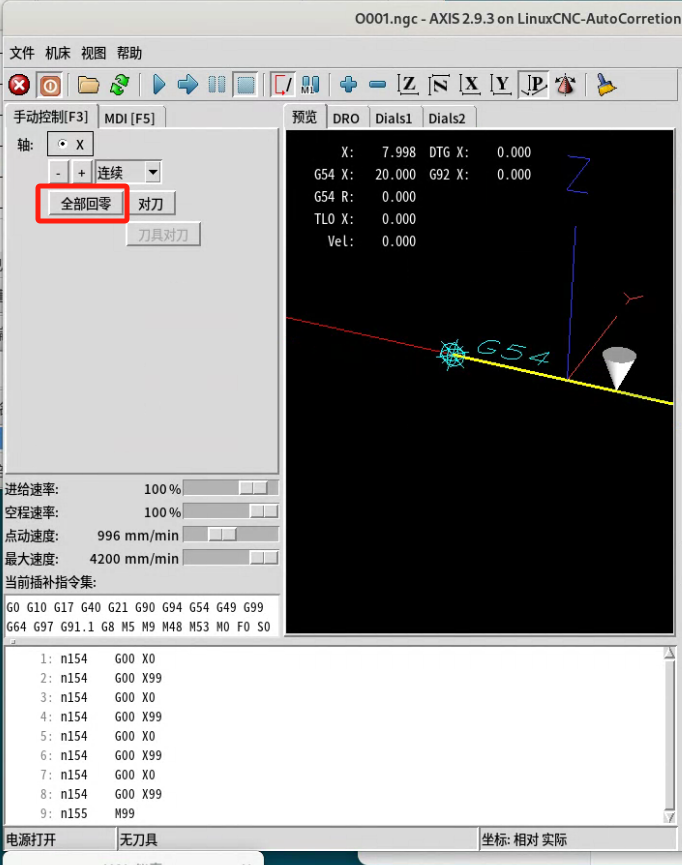

I am currently tuning a Linux CNC device to control the Ethercat motor. The motor driver I am using is absolute origin and does not require home. When I accidentally click on [home axis] on axisUI, causing my coordinate system to be misaligned. For example, if the current point is 10.00 and the motor does not move after clicking [home axis], the current point becomes X0.0 on G53, which may cause collisions during subsequent program runs. How can I disable axisUI's [home axis] function, Either it becomes invalid after clicking, or it disappears.

I have set the parameter of HOME_USE_INDEX = NO to "No” before, but if I am not careful or accidental, clicking on [home axis] will still set my G53 coordinate to 0. This will lead to the possibility of subsequent collisions.
I hope CNC will do nothing when I accidentally click on [home axis]
