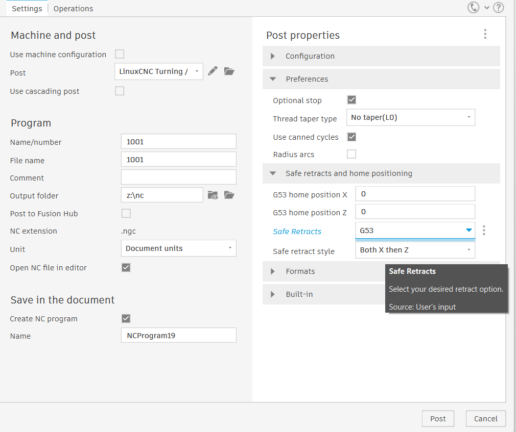

Hey,
I am completely new to CNC and linux so forgive me for the dumb question.
I have a CNC lathe (Emco compact 4) with LinuxCNC and I have an issue issue with my gcode.
I posted my CAM in fusion 360 using the LinuxCNC Lathe post processor. When I load the g-code into LinuxCNC on my lathe i get an error Bad character 'U'. From what I can tell it's becasue of G28 U0? Should it be X0 instead of U0? Likewise for W0 should be Z0? Can i just change the code to this and run it? Why does Fusion 360 create U and W axis instead of X and Z? Have I set something up incorrectly in CAM? Or is it the incorrect post processor? Or something wrong with my machine's LinuxCNC? Pasted my code below.
Thanks for any help.

If you just want to turn something you can delete lines N32 and N33.
It's the Fusion360 preprocessor that adds those two lines, don't know if there is a setting for the two extra axis U and W.

- frosted_jono
- Posts: 4
13 Feb 2025 09:02 #321426
by frosted_jono
Replied by frosted_jono on topic Bad character U.
Thank you Håkan. I will try that

On Fanuc lathe controls, "U" and "W" are incremental moves for X and Z.
I suspect many of the F360 posts are recycled Fanuc ones, and then edited to make them work for the intended control. Sometimes stuff gets left in that doesn't make sense.

13 Feb 2025 19:41 #321467
by frosted_jono
Yes this has fixed it! Thanks again.
