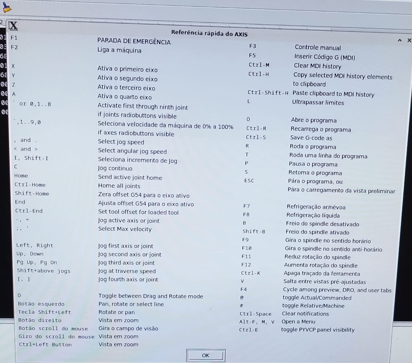

Keyboard Functions was created by ALS

Key bindings for axis start here:
github.com/LinuxCNC/linuxcnc/blob/7fc59f...cripts/axis.py#L3129
If you are running a Run In Place version of LinuxCNC, you can simply navigate to that file and modify them. It gets more tricky if you have a package install, but definitely possible.

Thank you very much for the quick response, it will be very useful to me...
