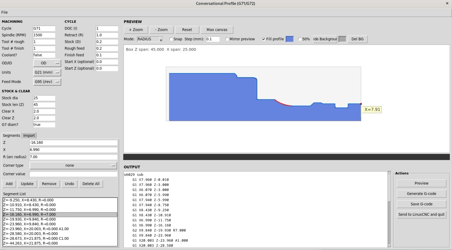

Hi guys,
Created this simple, but effective profile editor for myself.
It is a lightweight Tk-based conversational editor for lathe profiles, designed for LinuxCNC / PathPilot style workflows.It lets you sketch, edit, and preview turning profiles interactively, then generates a G71 or G72 roughing cycle with a G70 finish pass. All core functionality uses only the Python standard library (Tk), so it can be dropped directly into a AXIS environment.Optional DXF / 3MF import is supported via external libraries.
For example you can:
- import an STL as a background reference
- Auto create segment points or (recommended) tracing the rotational outline with profile points
- Adding chamfers and radii for finishing details
- Adjusting geometry for optimal cutting
- Setting machining parameters
- Generating G-code
- Sending to LinuxCNC/AXIS

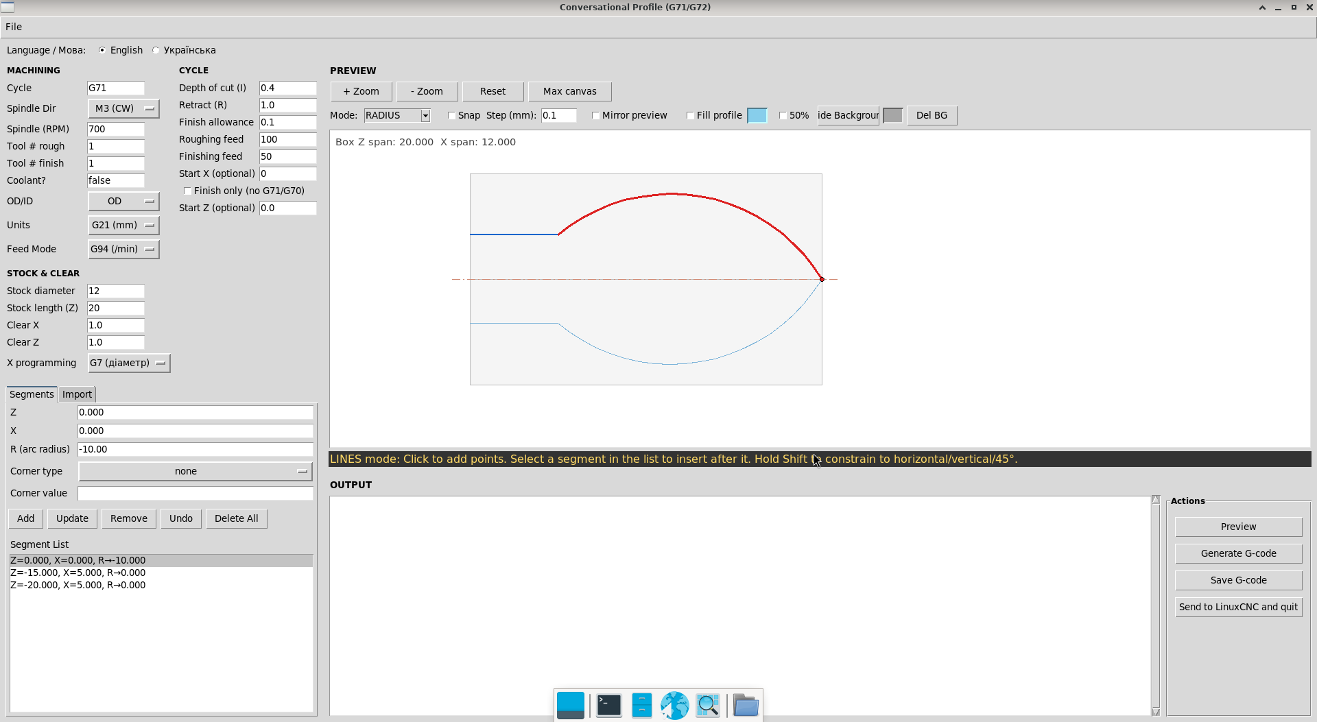

Hi everyone! I'm not a programmer, I have a small lathe (LinuxCNC 2.9.8, Mesa 7I96S), and I'm slowly learning. I found a few real issues in the profiler — some of them can actually cause the tool to crash into the workpiece. All fixes were made together with Claude (AI), and tested on real hardware.What was fixed:
- English/Ukrainian language switcher at the very top of the window (English by default)
- D and I were swapped in G71/G72, plus incorrect scaling for G7 (diameter mode) — the actual depth of cut was twice the value entered
- unsafe G71→G70 transition — for certain Start X values the tool wouldn't retract and crashed into the part
- Start X / retract didn't account for arcs (G2/G3) "bulging" beyond their endpoints
- added a "Finish only" mode — re-run just the last pass without G71/G70
- added a safe approach move at program start, from any starting position
- improved preview (symmetric, centerline at X=0) and DXF import
File and detailed changelog (CHANGES.txt) attached. If it's useful to anyone, feel free to grab it.
