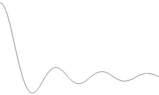

21 Mar 2011 20:03 - 21 Mar 2011 20:24 #7983 by steve714
I wish to machine a math sculpture in 3d, for example, a sinc function [z=(sin(x)/(x)].
The equation is in 2D, and it needs to be set up along the x and z axis, then rotated symmetrically around the z-axis in the x-y plane to create the 3D image. The result would look like a sombrero hat.
It may be possible to create the 3D image in another program like MathCad, but how could I get it into AXiS (or PythonVCP)?

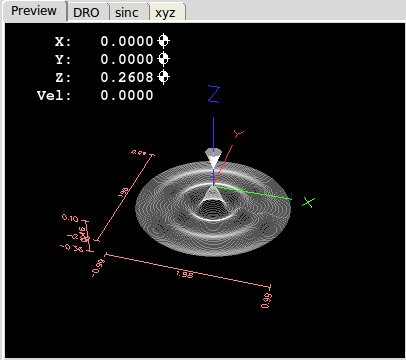

27 Mar 2011 19:39 #8169 by dgarrett
Replied by dgarrett on topic Re:How to create 3D shape via a math function?
An example 3d shape (sin(x)/x) using ngcgui:

27 Mar 2011 21:01 #8171 by andypugh
Replied by andypugh on topic Re:How to create 3D shape via a math function?
steve714 wrote:
It took awhile to try your code, but I could not get AXIS to stop complaining about the G3 line of code.
I should have pointed out that it was untested code, written off the top of my head, with no access to a CNC machine at the time.
The problem is that I forgot that IJ format arcs are incremental by default. The code I showed will work if you put G90.1 at the beginning. Alternatively make the G3 line say
G3 F1 I [#1 / -400]
