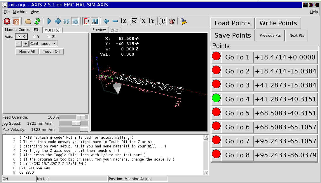

14 Apr 2013 18:58 - 14 Apr 2013 19:01 #32722
by ArcEye
Replied by ArcEye on topic Programming a 'custom' button
Hi
I have written a userspace module called points, along the lines I outlined.
Attached is a simulator based upon axis_mm which incorporates it.
Place the folder /points in your /home/yourname/linuxcnc/configs folder
Copy the binary points in that folder to /usr/bin
Create a blank file called /usr/share/linuxcnc/points.txt (touch /usr/share/linuxcnc/points.txt)
An item to note, points captures co-ordinates in machine co-ordinates and outputs G53 commands
(press # to display machine co-ordinates and the DRO and captured points will make sense)
The code is here, however note you would have to patch comp as described in the code, to be able to compile the code as it is.
It is not a polished item and not warranted fit for any purpose whatsoever.
Just shows what is possible and how flexible Linuxcnc is.
regards

signal(SIGTERM, adios);
// flags to prevent cycling whilst button depressed
saved = loaded = written = next_pressed = previous_pressed = go_pressed = 0;
bzero(buffX, 80);
bzero(buffY, 80);
bzero(buff_cmd, 120);
while(!done)
usleep(100000);
FOR_ALL_INSTS()
// button pressed to save current points
if(savepoints && !saved)
if(point_index == 8) // if array full go back to start
point_index = 0;
*(inst->xout[point_index]) = xposition;
*(inst->yout[point_index]) = yposition;
point_index++;
saved = 1;
// button pressed to load points from file
if(loadfile && !loaded)
FILE *fptr1;
fptr1 = fopen(points_file, "r");
if(fptr1 != NULL)
point_index = 0;
retval = 1;
while(retval && (point_index < 8))
if(fgets(buffX, 80, fptr1) != NULL )
*(inst->xout[point_index]) = atof(buffX);
else
retval = 0;
if(fgets(buffY, 80, fptr1) != NULL )
*(inst->yout[point_index]) = atof(buffY);
else
retval = 0;
point_index++;
point_index--; // it will be one higher than it should be
fclose(fptr1);
loaded = 1;
printf("Points loaded from %s\n",points_file);
else
printf("Failed to open %s\n", points_file);
// button pressed to write points to file
if(writefile && !written)
FILE *fptr2;
fptr2 = fopen(points_file, "w");
if(fptr2 != NULL)
for(j = 0; j < 8; j++)
fprintf(fptr2, "%09.04f\n", *(inst->xout[j]));
fprintf(fptr2, "%09.04f\n", *(inst->yout[j]));
written = 1;
fclose(fptr2);
printf("Points written to %s\n",points_file);
else
// next and previous points buttons
if(next && !next_pressed)
point_index++;
next_pressed = 1;
if(previous && !previous_pressed)
point_index--;
previous_pressed = 1;
// update current points LED
if(point_index > 7)
point_index = point_index - 8;
if(point_index < 0)
point_index = point_index + 8;
if(j == point_index)
*(inst->select[j]) = 1;
else
*(inst->select[j]) = 0;
// check for goto button activation
if(!go_pressed)
if(*(inst->gotoXY[j]))
go_pressed = 1;
sprintf(buff_cmd, "axis-remote --mdi 'G53 G00 X%9.4f Y%9.4f'", *(inst->xout[j]), *(inst->yout[j]) );
system(buff_cmd);
break;
// zero the flags if the relevant button has been released
if(!savepoints && saved) saved = 0;
if(!loadfile && loaded) loaded = 0;
if(!writefile && written) written = 0;
if(!next && next_pressed) next_pressed = 0;
if(!previous && previous_pressed) previous_pressed = 0;
if(go_pressed)
go_pressed = 0;
go_pressed = 1;
break;
} // FOR_ALL_INSTS
}// while(!done)
exit(0);
regards

That might not be necessary any more:
git.linuxcnc.org/gitweb?p=linuxcnc.git;a...b0657e9655236f614353
(Or might be more necessary)
Replied by andypugh on topic Programming a 'custom' button
The following user(s) said Thank You: beltramidave

Sebs patch is far more comprehensive than my quick hack.
Excellent, I was not aware of that, great minds obviously think alike. (or fools never differ!)
It certainly makes programming, using arrays of pins in particular, much easier.
cheers
cheers
