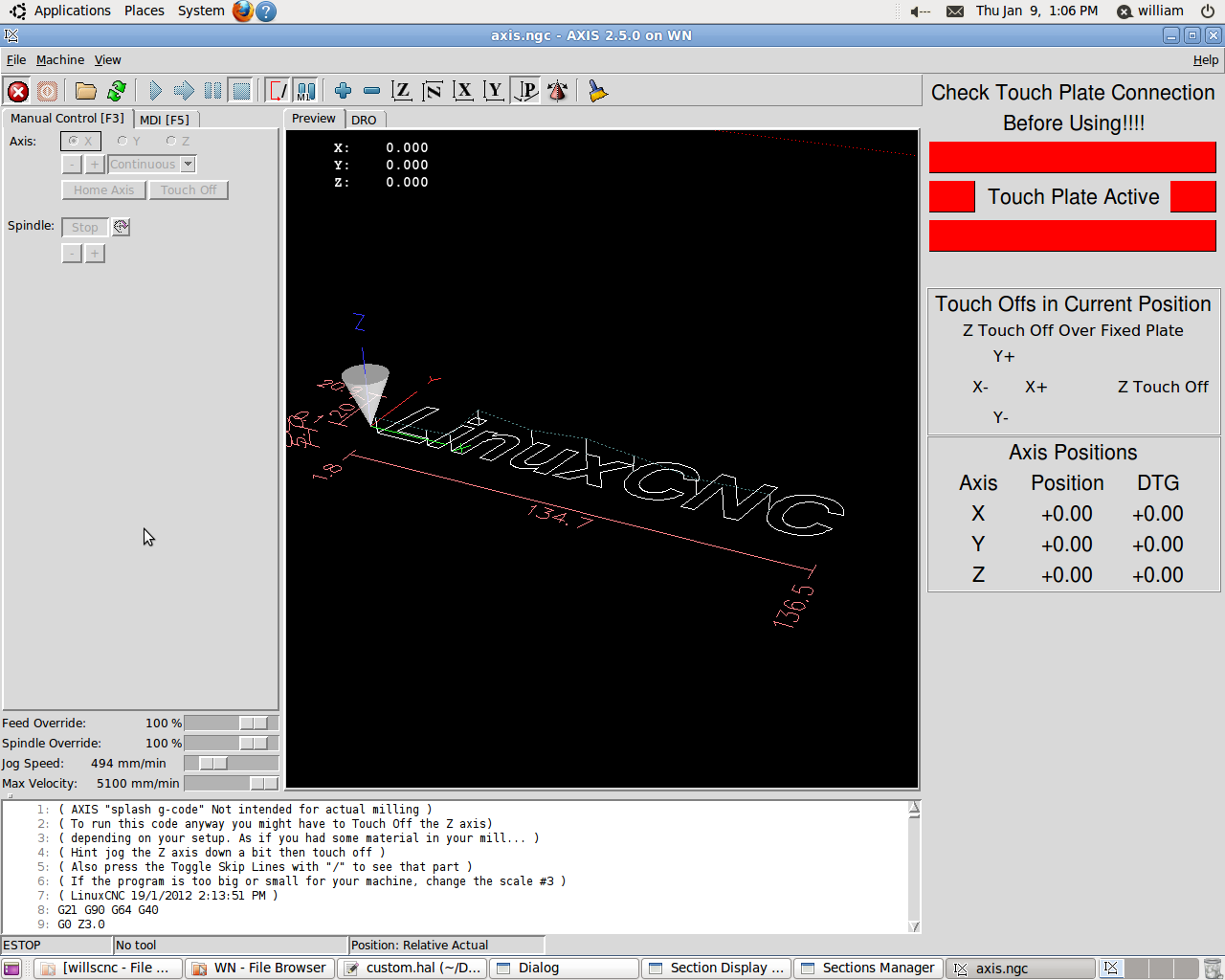

Hello everyone,
I have my router working pretty well now, still needs a few upgrades to be better but I'm happy at the moment.
Anyway, i'm up to making LinuxCNC have a side bar with added buttons and LEDs and XYZ cords.
Well i have the LEDs working as i like as they where hooked up pretty easy to the touch plate.
The XYZ cords. where easy as well cause they just used the signal that is already there.
What I'm having trouble with is i have DTG (Distance to go) on the tab beside it but cannot workout how to get this to show up like in the DRO tab, if anyone could help me out that with what code i need here that would be great, I've been looking and playing with this for some time now and it's got me going round in circles.
Also looking at doing touch off buttons for Z X+ X- Y+ Y- to set the 000 point or each one by its self, i have studied all the docs i can see on the internet but the classic-ladder stuff has been doing my head in, does anyone have any good advice on how to achieve what I'm after or any tutorials on this that explain it in on go in "layman's terms".
Anyway hope all this understandable and hope you can understand what I'm trying to achieve.

Thanks for that, and the fast response.
It helps a little bit.
Most of the ones i have seen run 2 lines of MDI code and use classic ladder and pyvcp, but they are doing my head in as I'm trying to do more than just one axis as I'd like to also do a x,y touch off to set 0 to one corner.
Also still stuck on the DTG, for all axis and each individual axis, will post a screen capture and the xml file (it's a bit messy) so anyone can see what I'm trying to achieve, may still make changes to the screen but this should give people the idea.
Any more help would be great.
William

There is not pin AFAIK which gives your distance to go, you need to subtract axis.N.joint-pos-fb from axis.N.joint-pos-cmd
ie actual from commanded position
www.linuxcnc.org/docs/devel/html/man/man9/axis.9.html
To do that you would have to set up a component to constantly read both and output a value
It might give a pretty, busy display, but I find DTG about as useful as a chocolate fire guard and have it turned off the whole time.

If you want to do more than a single MDI command make a subroutine to do what you want and call it as a MDI command in your .ini file
for example to go home...
In your ini file use something like...
#MDI_COMMAND = o<home> call
Where the called sub is...
To set your touch off with gcode look at G10L2 and G10L20
linuxcnc.org/docs/html/gcode/gcode.html#sec:G10-L2_
Never had a reason to even look at DTG myself.
Rick G
