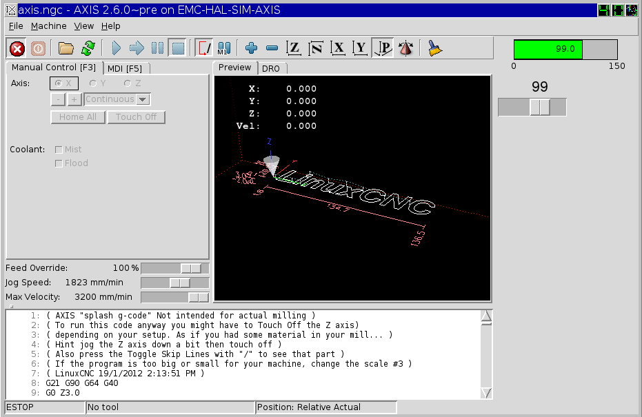

I did my first attempt at a pyvcp panel today with pretty good success. I did a spindle load meter and it works nicely. I used the bar widget for the display but would really like to have green yellow red regions/ zones on the bar. I seen that the meter widget allows setting of regions like this but could not find any info on doing similar with a bar.
I would prefer to use the bar display rather than the meter. I think glade allows a bar with regions but would rather use pyvcp if possible.
Is there any way of doing regions like this on a pyvcp bar?

Both the dial and the bar are subclassed from a TkInter Canvas so I don't see why you can't add that. In a RIP the file is lib/python/pyvcp_widgets.py.

There is now.
Because there is no dial and needle, it does not make much sense to have a coloured scale, but the colour of the bar itself can be changed to reflect its state.
Comment out the original class pyvcp_bar in pyvcp_widgets.py
Then insert this code
The revised widget takes 3 range definitions (you must use all 3 or none will be used, if you just want 2, set 2 of them to the same colour)
If these are set the bar colour will change depending upon the value of the pin
xml file snippet
postgui hal file snippet
and results
bar changes colour with increase in value within the ranges set
regards
Replied by ArcEye on topic bar widget, are regions possible?
There is now.
xml file snippet
<pyvcp>
<hbox>
<bar>
<halpin>"my-bar"</halpin>
<min_>0</min_>
<max_>150</max_>
<bgcolor>"grey"</bgcolor>
<range1>(0,100,"green")</range1>
<range2>(100,130,"orange")</range2>
<range3>(130,150,"red")</range3>
</bar>
</hbox>
<hbox>
<scale>
<font>("Helvetica",16)</font>
<width>"25"</width>
<halpin>"my-hscale"</halpin>
<resolution>1</resolution>
<orient>HORIZONTAL</orient>
<initval>0</initval>
<min_>0</min_>
<max_>150</max_>
</scale>
</hbox>
</pyvcp>
net bar1 pyvcp.my-bar <= pyvcp.my-hscale-f
and results
regards

WOW ! I cannot thank you enough! Coming to linuxcnc as a former mach3 user, I just love linuxcnc and am constantly telling people about it, ESPECIALLY the unbelievable support!!! Support like this is beyond what anyone could reasonably expect.
Thanks so much!
I am off to add the code!
George
Follow up Works just as advertised !! Thanks once again for the effort and great support.
Thanks so much!
George
