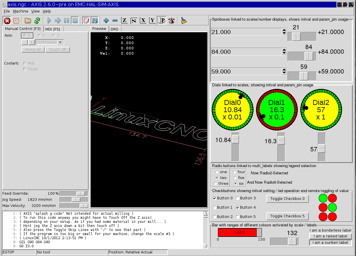

Hi Chris
(EDITED 1535)
Now hopefully sorted, I had somehow edited a previous version of the file when I added the latest changes and broke stuff along the way.
If you download the zip from the link on the first post of this thread, it contains the new py file and a config which will give you a panel like this
This demonstrates that the initial values can be preset and shows the sliders linked to the param_pin s of the dials and spinboxes to alter their values directly
( you would never actually do that, just shows the linkage)
The multilabel widget is working when different radio buttons are selected.
( The problem you had was partly that I had incorrectly shown <disable_pin>"False"</disable_pin> in the html page or the code header, which would change a bool to a text string if you used it like that )
The bar widget changes colour as the linked slider beneath it is moved across.
There is also a pushbutton next to the checkboxes, which is connected to the changepin of checkbox 0 to demonstrate remote toggling
I now need to have a purge of my system for any orphaned versions to stop this occuring again :angry:

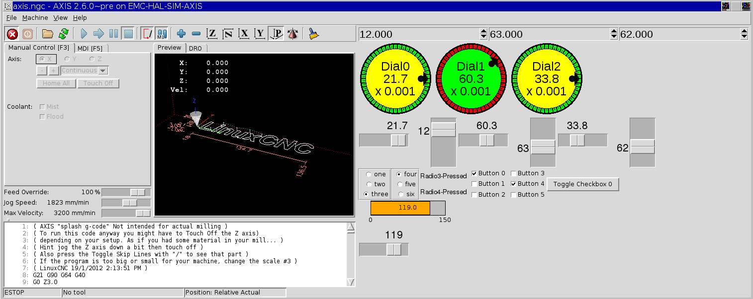

Hi Chris
I came up with this panel which uses most of the widgets (meter, table, tabbed widget and jogwheel not covered, but they are in the docs)
It also demonstrates spacing, frame and their styles etc.
The zip of the config including xml and hal files is attached
regards
