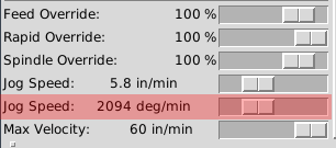

I have my "MONSTER" mill set up and running, you can search the threads for much more detail... but this was an issue I wanted to resolve in a separate thread as others may also be looking for an answer to this question.
I set up a milling machine with X-Y-Z-A axis... it is working just fine.
I added a pyVCP panel to the setup which is also working fairly well.
I noticed that when running the A-Axis it was going very slowly... but then I figured out why... the AXIS panel has TWO JOG SPEED controls... one for the X-Y-Z axis... and the second for the A-Axis only. The X-Y-Z has a top speed of 60 inches per minute, and the A-Axis has a top speed of 3600 deg per minute.
Ok... I get that... I need to create a second JOG SPEED slider in my panel and set up a proper NET to make it function.
Well... it's been 8 hours... and I'm just not getting it right... here are some code snippets...
THE pyVCP XML Code
And I'm pretty sure this line : <halpin>"rotary-jog-speed"</halpin> needs to be changed... or that the reference in the post gui file needs to be changed... but I'm going to admit that I only partially understand this functionality... so your help is really appreciated.
Custom Post GUI File Snippet
And I can identify that my issue in this section is this: halui.rotary-jog-speed
I can comment out this line... # net panel-rotary-jogspeed halui.rotary-jog-speed <= pyvcp.rotary-jog-speed-f so it looks like this...
And the machine AXIS will start up.
So I need to know what halui signal I'm looking for... it appears halui.jog-speed is only for the XYZ... but I can't seem to find a reference to an a-jog-speed or 3-jog-speed so what am I looking for? Or what are the code replacements to try??
Thanks,
Jerry

22 Aug 2015 22:14 - 22 Aug 2015 22:28 #61651
Replied by PCW on topic 2 Independent Jog Speed Controls (One for A-Axis)
man halui
( since there _is_ only one jog speed setting available its up to you to change this
to an appropriate axis dependent value either with a mux in hal or elsewhere )

22 Aug 2015 23:24 - 22 Aug 2015 23:26 #61652
by Askjerry
Replied by Askjerry on topic 2 Independent Jog Speed Controls (One for A-Axis)
I'm afraid i don't understand you... so far, everything I know about AXIS and HAL has been self-taught.
I can make the PYVCP panel and include a second slider... but in the HAL file is where I have the issue...
# connect the PyVCP XYZ jog speed slider
net panel-jogspeed halui.jog-speed <= pyvcp.jog-speed-f
# connect the PyVCP A jog speed slider
net panel-jog-a-speed ???????? <= pyvcp.jog-a-speed-f
Presuming I make the PYVCP slider control thus...
<vbox>
<relief>RAISED</relief>
<bd>2</bd>
<label>
<text>" A Jog Speed"</text>
<font>("Helvetica",10)</font>
</label>
<scale>
<halpin>"jog-a-speed"</halpin>
<orient>HORIZONTAL</orient>
<resolution>1</resolution>
<min_>1</min_>
<max_>3600</max_>
</scale>
</vbox>
I need the HAL code, or instructions... that's what i am missing. I need to emulate what happens when you manually slide the second slider in AXIS. It sounds like what you are suggesting is some kind of a PY program that gets called or something similar... not something I have done as of yet. Can you please post more details?
thanks,
Jerry

- Posts: 18886
- Thank you received: 5213
22 Aug 2015 23:41 #61655
Right, so notice there is only one jog speed setting: halui.jog-speed
this means that you need to change the value of this pin depending on which
axis you are jogging if you want A to jog at a different rate than X,Y,Z

22 Aug 2015 23:50 - 23 Aug 2015 00:53 #61656
by Askjerry
I get that...
I could create the second slider... and it would hold a valid number... the issue is... when I click the A-MINUS or the A-PLUS button... they look like this in the PYVCP...
<hbox>
<bd>3</bd>
<button>
<padx>25</padx>
<font>("Helvetica",14)</font>
<width>3</width>
<halpin>"a-minus"</halpin>
<text>"A-"</text>
</button>
<button>
<padx>25</padx>
<width>3</width>
<halpin>"a-plus"</halpin>
<text>"A+"</text>
</button>
</hbox>
They would need TWO halpins assigned...
and the second one would need to link panel-jog-a-speed to halui.jog-speed
Hummm... I have not tried putting two halpin references in a single button... I'll give that a try... but honestly, I'll be surprised if it doesn't fail.
Going to try that now...
UPDATE - No, you cannot have two <halpin>__</halpin> in a PYVCP object... or more correctly... you can... but only the last gets accepted, the others are ignored.

Might I suggest that the button that jogs the A axis also set the jog speed from the slider when it is pressed and also the same with other axes.
Edit: a mux2 should do the trick.
