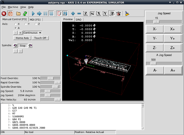

Ok... that suggestion took me to this example...
Jogging With Buttons On A Pendant
They are using two feeds... fixed... but I think I can point the values to the two sliders instead...
Code snippet...
# set the jog speed
setp mux2.0.in0 25
setp mux2.0.in1 100
net remote-speed-select mux2.0.sel <= pyvcp.jog-speed.Fast
net remote-jog-speed halui.jog-speed <= mux2.0.out
Not exactly there yet... but something to experiment with... I think this gets me about 60% there... I'll update if i find anything.
I am attaching everything I have so far...
Thanks ~ Jerry
