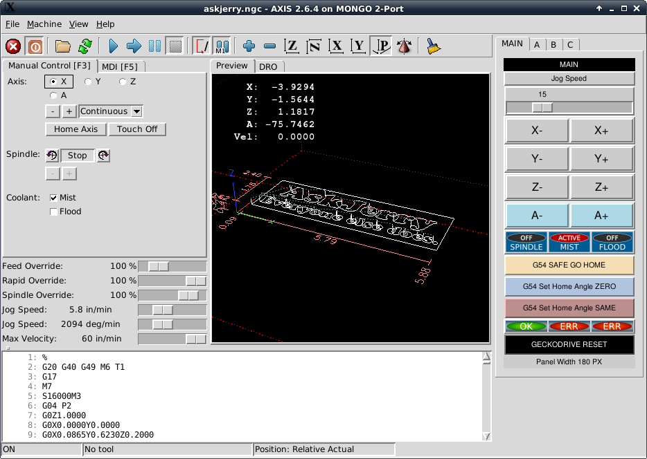

I was making a panel and wanted to use black <bg>#000000</bg> for the background... which of course means that I would need a different foreground color... like white.
I was wondering... since <bg> was short for background... would't <fg> would work for foreground??
I searched for <fg>... but it returned NO MATCH anywhere in the manual. I tried it anyway, and it worked.
I just thought you may want to add that information as it seemed to be missing.
linuxcnc.org/docs/html/hal/pyvcp.html#_label
	      <button>
			<padx>25</padx>
			<font>("Helvetica",8)</font>
			<halpin>"gecko-clear"</halpin><!-- Assigned to Parport 1, pin 14 RELAY -->
			<text>"GECKODRIVE RESET"</text>
			<bg>"#000000"</bg>
			<fg>"#ffffff"</fg>
		</button>
Panel Screenshot...
Last edit: 26 Aug 2015 07:02 by Askjerry.

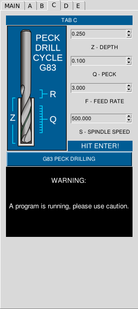

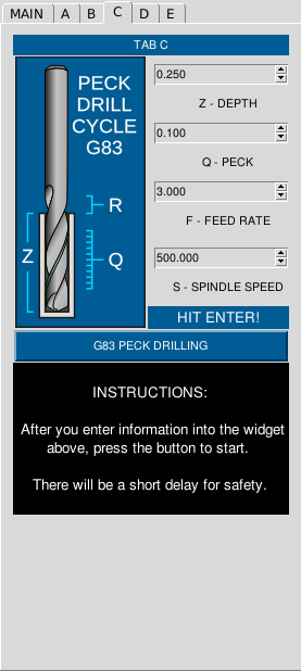

I made a really cool discovery... well... for me anyway... I found that I could insert LINE BREAKS into the <label></label> and <multilabel><multilabel> objects. I was wondering if using the "\n" would work or not... and it does.
Here is the XML from a section of my PECK DRILL pyvcp panel...
<!-- Instruction message with text wrapping and updates. 					  -->
<multilabel>
	<halpin>"peck-drill-notice"</halpin>
	<!-- Set label information here... big run-on lines... can't be helped.                   -->
	<legends>["\n INSTRUCTIONS: \n \n After you enter information into the widget above, press the button to start. \n \n There will be a short delay for safety. \n", "\n WARNING: \n \n \n A program is running, please use caution. \n \n \n"]</legends>
	<!-- Finish label information here...                                                     -->
	<wraplength>"250"</wraplength>
	<justify>"center"</justify>
	<font>("Helvetica",10)</font>
	<bg>"#000000"</bg>
	<fg>"#ffffff"</fg>
	<width>22</width>
</multilabel>
The label is then associated with PROGRAM... if it is running or if it is idle.
Here is the section of my postgui file...
# Custom settings.
net panel-PGM-RUN	<= halui.program.is-running
net panel-PGM-IDLE	<= halui.program.is-idle
# Set up PECK-DRILL and BOLT-HOLE announcement system. (Multilabel Messages)
net panel-PGM-IDLE	=> pyvcp.bolt-hole-notice.legend0	# Display IDLE message.
net panel-PGM-RUN	=> pyvcp.bolt-hole-notice.legend1	# Display WARNING message.
net panel-PGM-IDLE	=> pyvcp.peck-drill-notice.legend0	# Display IDLE message.
net panel-PGM-RUN	=> pyvcp.peck-drill-notice.legend1	# Display WARNING message.
And here is the panel in operation...
