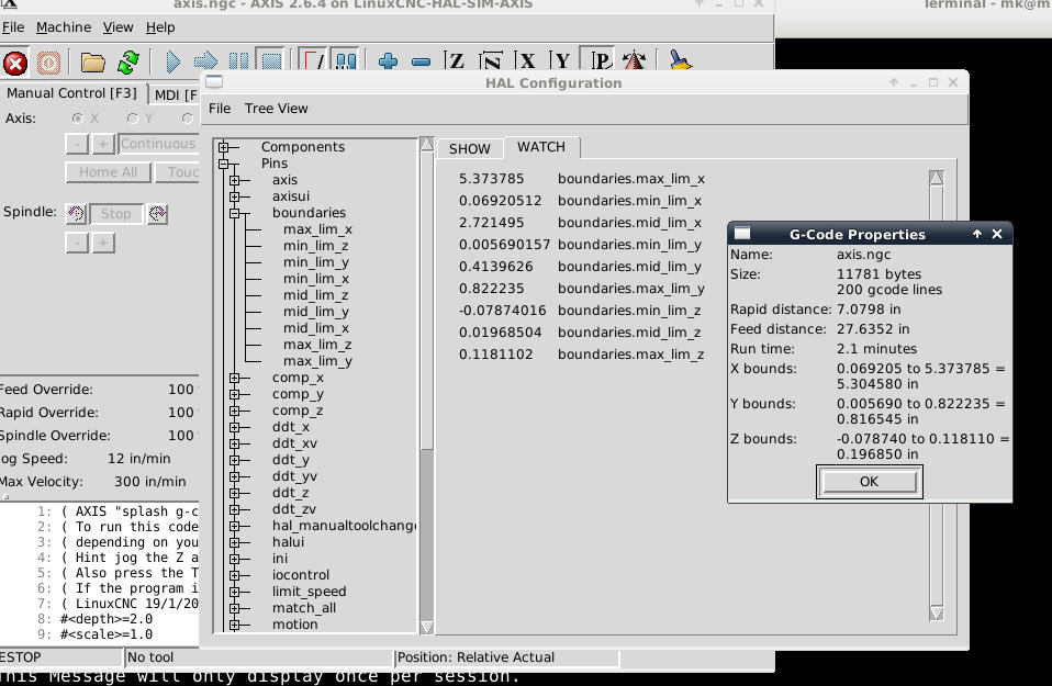

Hi All
Is there a way/variable that i can use to display the Max/Min of XYZ from a loaded Gcode file??
Doug
Doug

As a side note.
The Axis display shows the min and max of the program and defaults to relative position.
You can select machine position from the view tab to see the min max machine position.
Rick G
Rick G

hi
here is my solution in .axisrc (in my homedir)
this code create new pin BOUDARIES and you can use it in pyvcp or glade.
I have problem with remap m6 code. Boudaries are calculated with path to tool change and i dont know haw to discard remap code from calculation.
Martin
if hal_present:
mycomp = hal.component("boundaries")
mycomp.newpin("max_lim_x",hal.HAL_FLOAT,hal.HAL_OUT)
mycomp.newpin("min_lim_x",hal.HAL_FLOAT,hal.HAL_OUT)
mycomp.newpin("mid_lim_x",hal.HAL_FLOAT,hal.HAL_OUT)
mycomp.newpin("max_lim_y",hal.HAL_FLOAT,hal.HAL_OUT)
mycomp.newpin("min_lim_y",hal.HAL_FLOAT,hal.HAL_OUT)
mycomp.newpin("mid_lim_y",hal.HAL_FLOAT,hal.HAL_OUT)
mycomp.newpin("max_lim_z",hal.HAL_FLOAT,hal.HAL_OUT)
mycomp.newpin("min_lim_z",hal.HAL_FLOAT,hal.HAL_OUT)
mycomp.newpin("mid_lim_z",hal.HAL_FLOAT,hal.HAL_OUT)
mycomp.ready()
if vars.metric.get():
conv = 1
else:
conv = 1/25.4
# this function is called at [DISPLAY]CYCLE_TIME interval
def user_live_update():
min_extents = from_internal_units(o.canon.min_extents, conv)
max_extents = from_internal_units(o.canon.max_extents, conv)
mycomp['min_lim_x'] = min_extents[0]
mycomp['max_lim_x'] = max_extents[0]
mycomp['mid_lim_x'] = min_extents[0] + (max_extents[0] - min_extents[0])/2
mycomp['min_lim_y'] = min_extents[1]
mycomp['max_lim_y'] = max_extents[1]
mycomp['mid_lim_y'] = min_extents[1]+ (max_extents[1] - min_extents[1])/2
mycomp['min_lim_z'] = min_extents[2]
mycomp['max_lim_z'] = max_extents[2]
mycomp['mid_lim_z'] = min_extents[2]+ (max_extents[2] - min_extents[2])/2 this code create new pin BOUDARIES and you can use it in pyvcp or glade.
Martin

Yep...Now that I opened my eyes I see the job overalls are already on the screen
Thats the way I'll go with display
