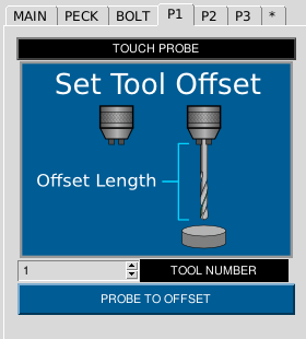

One of my YouTube viewers asked if I could make an automatic way to set the tool offsets in the table. I worked on it this evening, and I think I have a good solution. I wanted to pass it along... let you play with it... and see what you think.
I have (in theory) all the parts required in the attached archive file... there is also a "READ-ME" file with detailed instructions on how to set it all up. Again... input welcome.
NOTE: It is set up for METRIC... if you need INCH, you will need to change a few things.

interesting.
your image name does not match the image_bit in the xml file. your image file is also a png, and the docs specify gif.

Perhaps I grabbed the incorrect version... let me get the proper version for you.
This is my current Frankenlabs... I just pulled it from my hard drive and tested it as operational.
Yes... the image is a PNG... I do use some PNG files in my panels.
