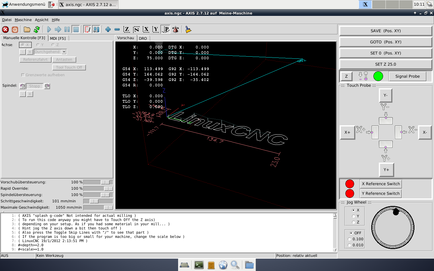

hello together,
at the moment I'm working again at my cnc-router and I'm just modifying my LinuxCNC Overlay.
You can see my screenshot in the attachments.
I don't know if this is possible with pyvcp or not, but I don't know how to make a image as a button. My solution for the moment are the buttons X+. X-, Y+, Y- next the images. I want to delete the buttons and want to press the images instead. How can I do that?
Second question is about my jogwheel. I don't know how to connect it. I don't have addons and if I run LinuxCNC, I'll get a error message like:
HAL: ERROR: function 'conv_float_s32.0' not found
custom_postgui.hal:23: addf failed
my 'custom_postgui.hal'
loadrt conv_float_s32 count=1
addf conv_float_s32.0 servo-thread
net jogwheel_float pyvcp.jog-wheel.output => conv_float_s32.0.in
net jogwheel_long conv_float_s32.0.out => axis.0.jog-counts axis.1.jog-counts axis.2.jog-counts

my 'custompanel.xml'
-<labelframe text="::: Jog Wheel :::">
<font>('Helevetia',10)</font>
<hbox>
<image_bit images="empty2"/>
<vbox>
<radiobutton>
<choices>["X","Y","Z"]</choices>
<halpin>"jog-axis"</halpin>
</radiobutton>
<radiobutton>
<choices>["OFF","0.100","0.010"]</choices>
<halpin>"jog-scale"</halpin>
</radiobutton>
</vbox>
<jogwheel>
<cpr>100</cpr>
<size>150</size>
<halpin>"jog-wheel"</halpin>
</jogwheel>
</hbox>
</labelframe>
The image_bit empty2 is only for optics, to get more distance between the widgets.
Thank you for your help and I'll hope I can realize my wishes without GVCP or other addons.
greetings Thomas
15 Feb 2018 21:48 #105994 by cmorley
Replied by cmorley on topic image as a button and jog wheel
pyVCP does not have an image button option - it would be a nice addition.
the ere comes from the fact that the conv_float_s32 component's name uses underscores but everything else related to it uses dashes.
addf conv-float-s32.0 servo-thread
net jogwheel_float pyvcp.jog-wheel.output => conv-float-s32.0.in
etc
Chris M

16 Feb 2018 09:59 #106008 by Thomas
Replied by Thomas on topic image as a button and jog wheel
thank you Chris.
So I don't have to search anymore to find a solution. I decide to try this with glade, but have to learn and read a little bit more.
