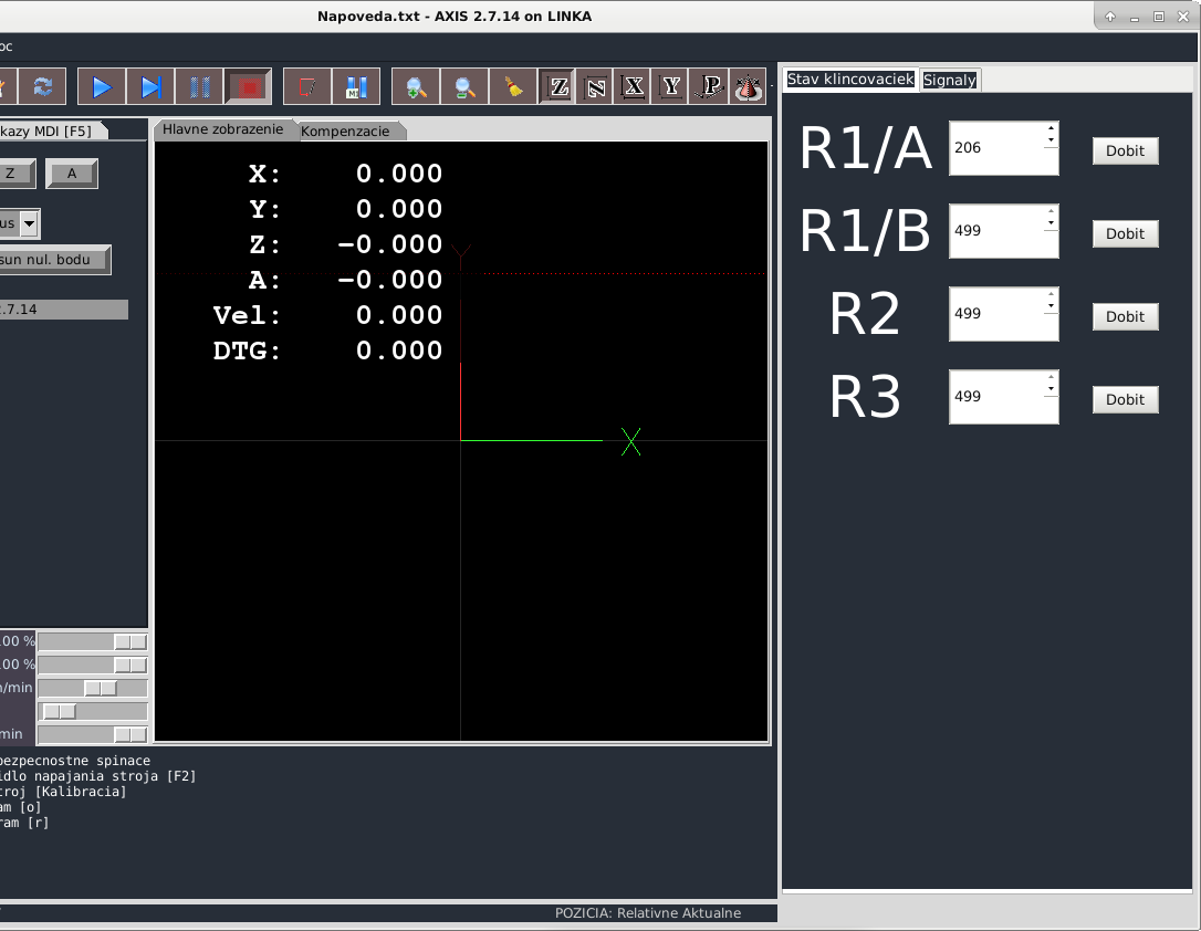

Hi, I need to update the spinbox value with some gcode. I have an automatic pallet line and after each shot (nail) i need subtract from spinbox nails. From 500 to 0. At value 0 must be a pause. Please help.

So, i have gladevcp panel
From .ini:
[HAL]
From GLADEVCP.uiThe Gladevcp.hal:
#empty
The dob_button.py ;no vorks
Now i need by button (bt_r1a) to change the value in spinbutton (r1a) to 499. I also need by a "G" , "M" or "Python" code (after each activation) reduce the value in the spinbox to 0. At value 0 will pause. How to do it?

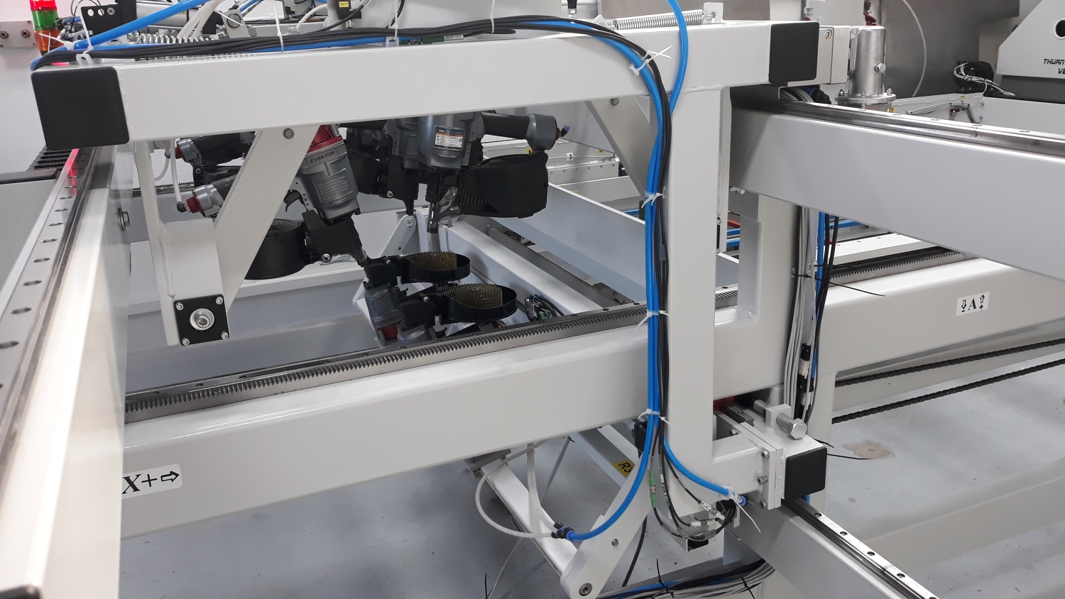

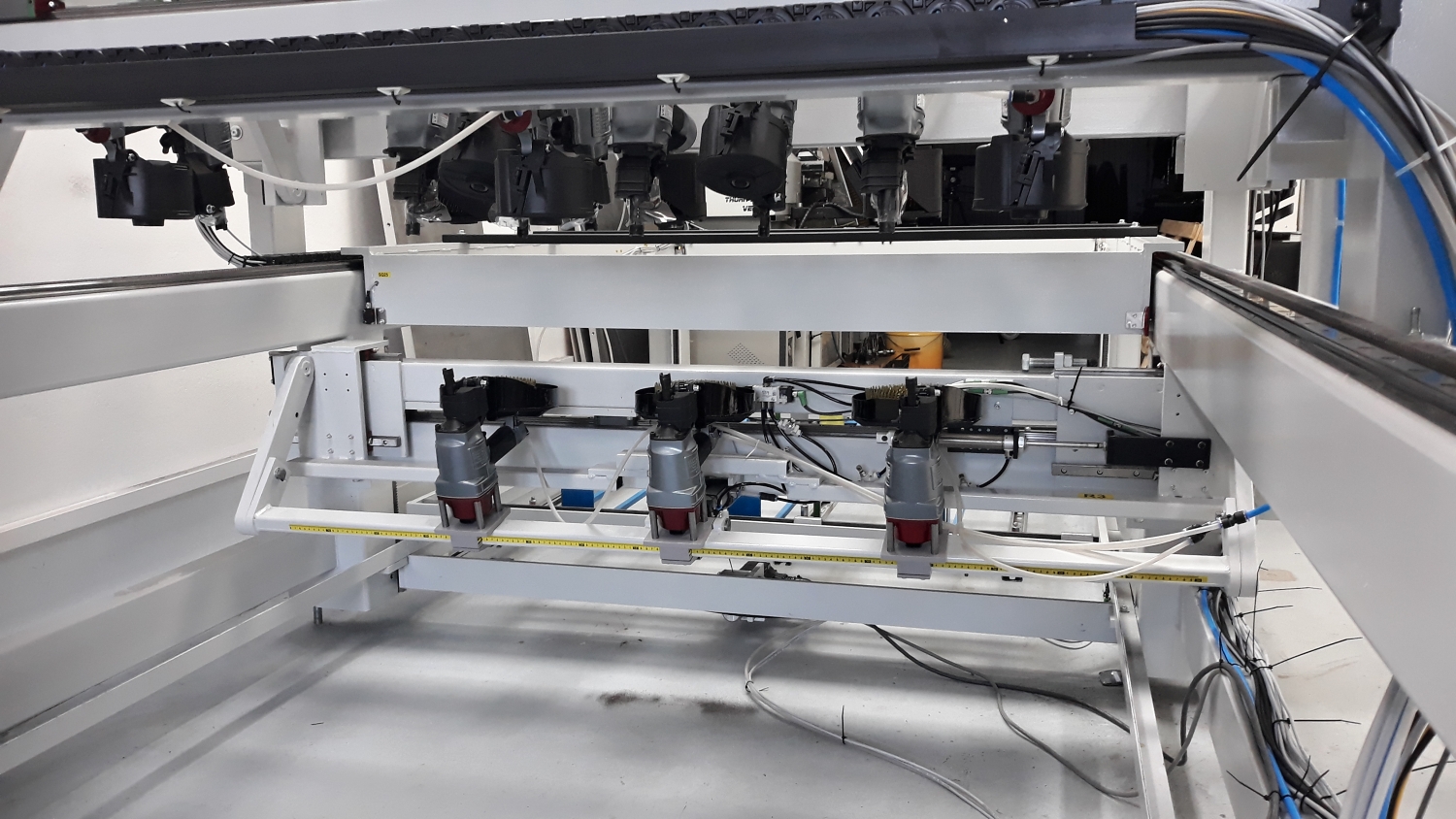

Are you using several large magazine coil nailers and just move the gantry over the boards to nail?

For imagination

Your handler file is coded to catch the button press but the says to set_value on the button.
You want it to set the value of the spinbutton.
You need to define a reference to the spinbutton first...
If you could post the GLADE file I'll see if I have time later to mock something up for you.

Thanks, but the button function is not essential. It's secondary. For me, the code that counts the nails is necessary. I have four rows of nails. Each works separately.

python handler file that initializes one of the spin buttons, and a HAL pin to control it.
The button will update the spin button to 499
The spin button counts down till 0 then prints 'pause' to the terminal
M105 file to toggle the HAL pin
you must add the Mcode path to INI- something like this:the file must be executable
The every time you add m105 to gcode it counts the spinbox down 1
That should be a good start to what you want.
Chris
[RS274NGC]
USER_M_PATH = ~/linuxcnc/nc_filesThe every time you add m105 to gcode it counts the spinbox down 1
