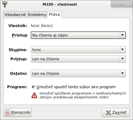

I have more "M" and remapped "G" codes. They work well. The paths are also right.
The yours mcode M105 is almost empty.
Command: halcmd setp gladevcp.test True ;without effect
Does it only test functionality?
INI:
INI:

Hi, everything works perfectly. (M105 and the "dob_button.py") Now I need to add HAL pin but other than "test". Please how?
My example:
py:
gladevcp.hal:
M101:
My example:
py:
#!/usr/bin/env python
import hal
import hal_glib
class HandlerClass:
def __init__(self, halcomp,builder,useropts):
self.builder = builder
self.example_trigger = hal_glib.GPin(halcomp.newpin('glad_r1b', hal.HAL_BIT, hal.HAL_IO))
self.example_trigger.connect('value-changed', self._on_example_trigger_change)
self.r1b_spinbox = self.builder.get_object('r1b')
def on_example_trigger_changed(self,pin):
if pin.get():
pin.set(False)
new = self.r1b_spinbox.get_value() -1
if new <=0:
self.r1b_spinbox.set_value(0)
print 'pause'
else:
self.r1b_spinbox.set_value(new)
def get_handlers(halcomp,builder,useropts):
return [HandlerClass(halcomp,builder,useropts)]gladevcp.hal:
net glad_r1b <= motion.digital-out-17M101:
#!/bin/sh
halcmd setp motion.digital-out-17 True
exit 0
Last edit: 20 Mar 2020 05:53 by jurod.

So, thanks for the link linuxcnc.org/docs/2.7/html/hal/halmodule.html from you.
I already have more pins created. Without a HAL.
I'm learning to work with python.
This my example is ok:
.ini:r2.py:M102:gcode:
later
Of course, all four buttons work for me.
Great thanks to Chris Cmorley
.ini:
GLADEVCP = -u savestate_gladevcp.py -u dob_button.py -u r_1b.py -u r2.py -u r3.py gladevcp.ui#!/usr/bin/env python
import hal
import hal_glib
class HandlerClass:
self.trigger = hal_glib.GPin(halcomp.newpin('glad_r2', hal.HAL_BIT, hal.HAL_IO))
self.trigger.connect('value-changed', self.on_trigger_changed)
self.r2_spinbox = self.builder.get_object('r2')
def on_trigger_changed(self,pin):
if pin.get():
pin.set(False)
new = self.r2_spinbox.get_value() -1
if new <=0:
self.r2_spinbox.set_value(0)
else:
self.r2_spinbox.set_value(new)
return [HandlerClass(halcomp,builder,useropts)]#!/bin/sh
halcmd setp gladevcp.glad_r2 True
exit 0later
