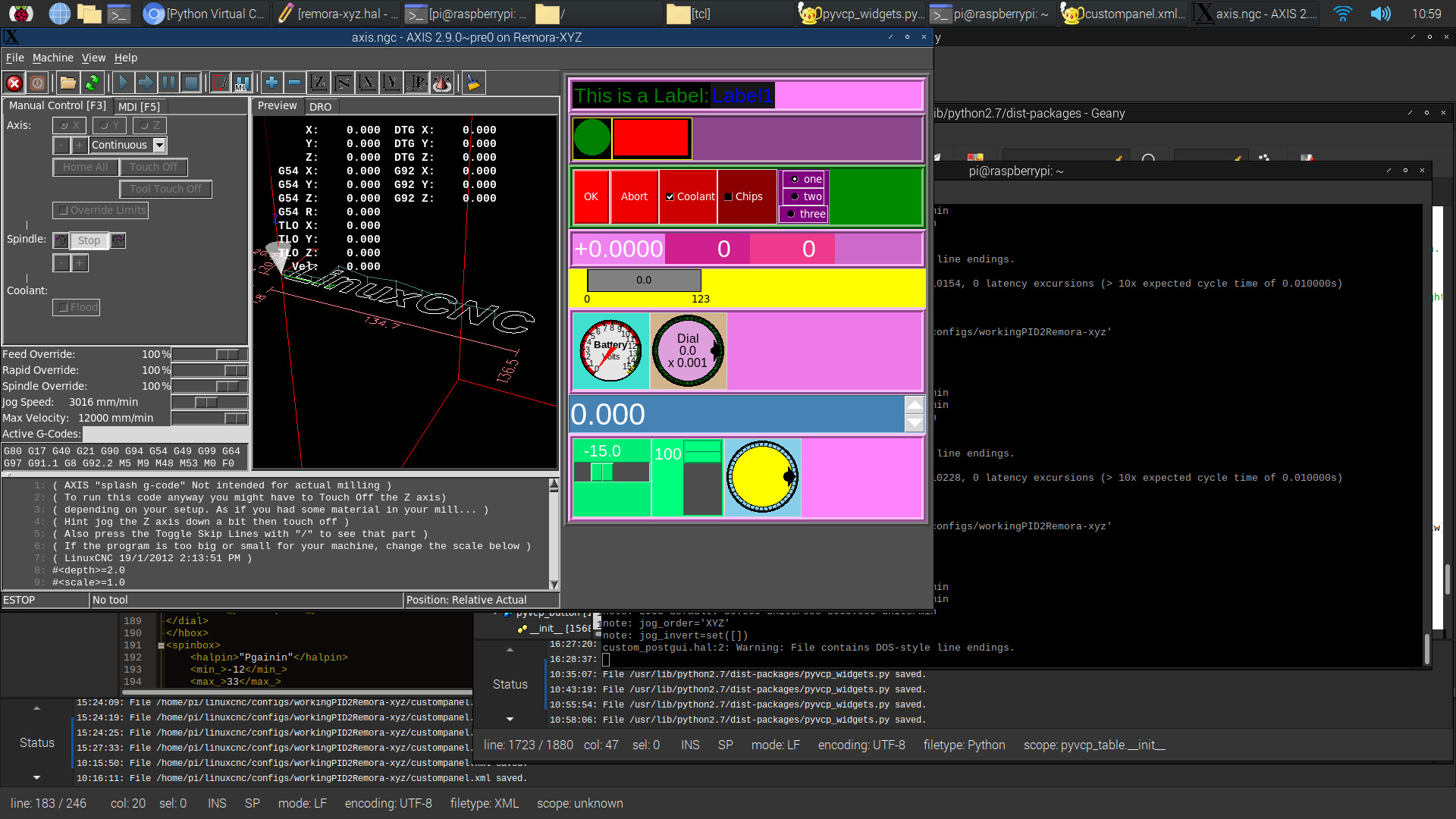

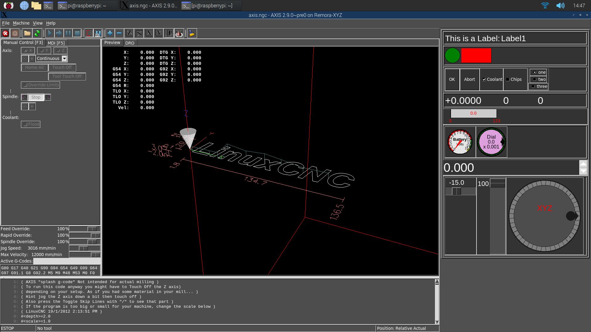

Hello,
in my quest to make a dark theme ui for axis i needed to add more color functionality to pyvcp_widget.py
I added elements to most widgets.
overview of the elements added
<fg>"colorname"</fg> Font color Default "black"
<bg>"colorname"</bg> background color, Default "#e4e4e4"
<hbc>"colorname"</hbc> Highlight background color "#e4e4e4" this is kinda like a border color
<hbt>1</hbt> Highlight background thickness this is kinda like a border
<sel>"colorname"</sel> radio/check button color
Without these options you could not create a dark theme ui because around all the widgets you would see the default bright gray (the leds and bars were the worst offenders as the entire blank space around them aka the entire canvas would be the default color )colors. With the added option above you can set them to be a rainbow or just to a dark gray such as gray16.
I added to the comments of each widget so one can see what options they can set.
I have attached the file and a picture of the options.
It looks like a bit terrible but was needed to test things out.
The axis.txt is a tcl file rename to axis.tcl
File is located at /usr/share/axis/
pyvcp_widgets.py file is located at
/usr/lib/python2.7/dist-packages/

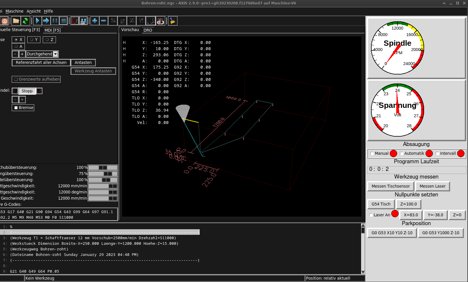

Has someone an example how to change color of pyvcp panel. I attached my usercomand file.

uhh personally I dont know, check some of the threads from askjerry a few pages back, he has some good looking pyvcp';s
to do it like aaron has, we probably need to push his updates for pyvcp_widgets.py
linuxcnc.org/docs/2.9/html/gui/axis.html..._x_resource_database
this way might change the pyvcp colours...
