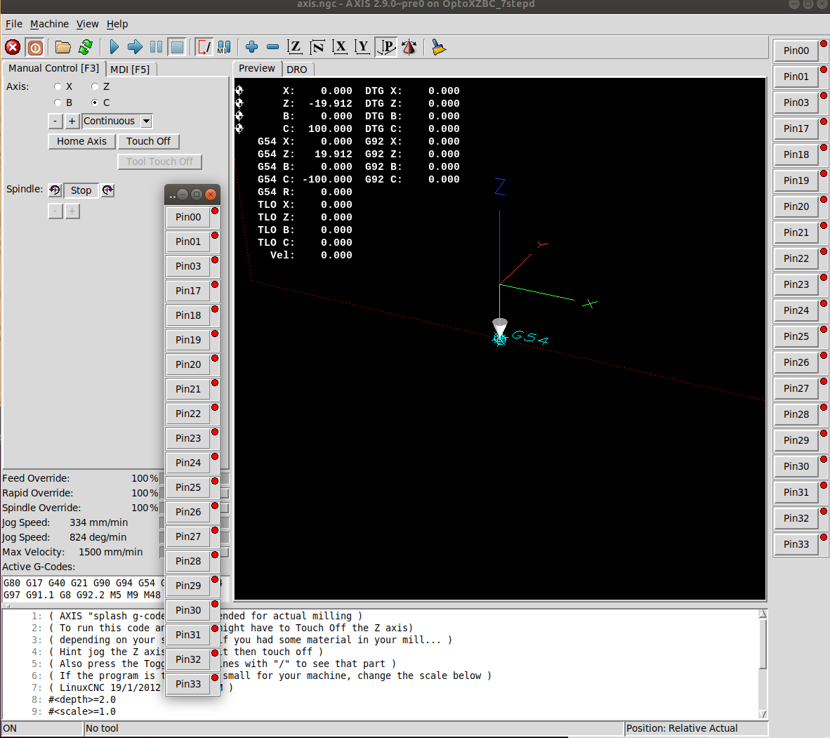

26 May 2021 20:19 - 26 May 2021 21:14 #210392
by vedatech
Replied by vedatech on topic Axis problem
Sorry, I got that backwards the .ini .hal, and postgui.hal that I originally sent cause linuxcnc to fail with the message:
" postgui.hal:23: Pin 'port_test.btn00' does not exist"
Running ">linuxcnc -d -v" on the command line shows that the .ini .hal, and postgui.hal were found and loaded but I don't see any reference to the port_test.xml file which defines the button names. Perhaps its not reading the .xml file?If I use both the .hal loadusr command and [DISPLAY] PYVCP = port_test.xml then I get both the Axis and stand alone buttons, but only the stand alone buttons work. So, port_test.xml is loaded correctly by the loadusr command but somehow not for the Axis only buttons even if I give the full path name in the .ini.
If I use [DISPLAY] PYVCP = port_test.xml in the .ini do I need to explicitly load the .xml somewhere else? Maybe its being loaded too late?
The attached screenshot shows what I get using both the .ini and .hal calls. The floating pins work, the Axis pins don't. I can't get the Axis panel without the floating panel.

27 May 2021 21:52 #210472
Replied by andypugh on topic Axis problem
Insert the command "show pin" at the start of the postgui.hal file, then start linuxcnc from the command line.
You will get a list of all the pin names at the point that the postgui.hal file runs, and that should help. (You can at least check that the pins are named correctly)
