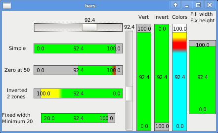

On a lighter note it appears we can only use horizontal bars to display numbers, how about vertical bars?

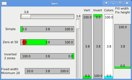

Yesterday HBar and VBar widgets were merged to gladevcp master branch
Here is GtkBuilder UI file:

Cool, just what I was looking for!
Is it possible to have the digital numbers have more than one decimal place?
Rick G

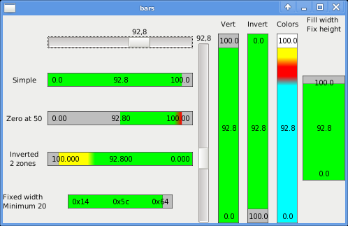

There is simple str conversion so if there are additional digits they will be displayed
I'll add parameter for format string so you'll be able to choose format you like

29 Nov 2010 19:10 #5743
by psha
Replied by psha on topic Re:What widgets are needed in a new version of VCP ?

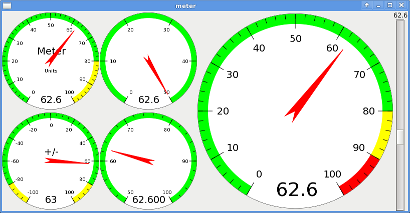

Today was another big merge and there are new widgets: HAL Meter and Graph.
Also there are lot of example configs and config for touchy with gremlin/graphs
More info is in mailing list thread.gmane.org/gmane.linux.distributions.emc.devel/3818
