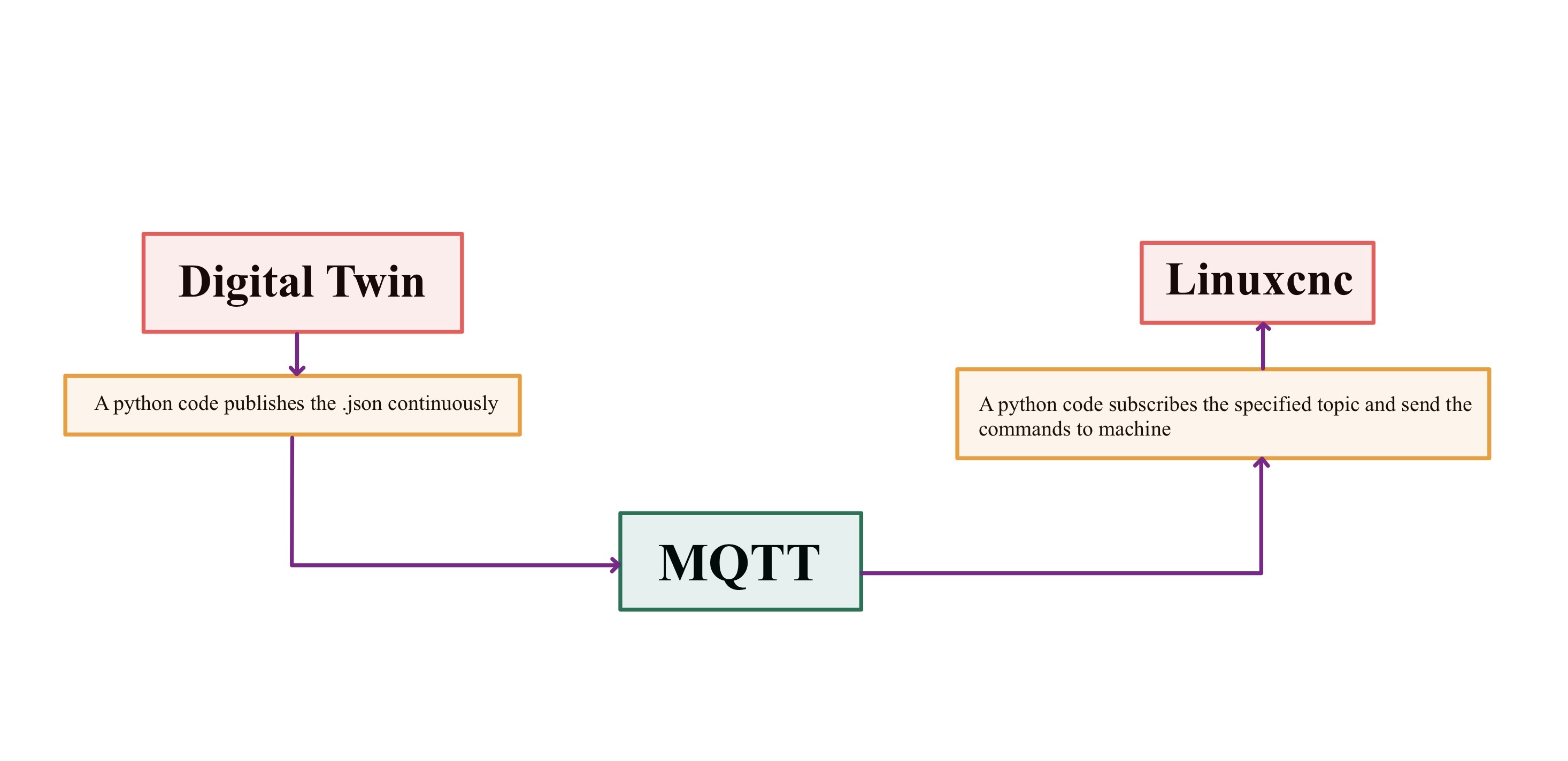

Hi everyone,I have a Linuxcnc machine and a Digital Twin (DT) and want to control the machine with DT over MQTT. The DT publishes the .json format data and the linuxcnc subscribes to the defined topic to get the data. (The digital twin installed on an Ubuntu system and the version of linuxcnc is 2.8). Here is also a schematic of what I want to do:
For example we want to stop machine from digital twin and there is a stop button in DT. When I press that virtual button, the related variable which stored in .json file changes and this change publishes by MQTT. In the other side the python code should receive this message and extract the data and implement the commands. As soon as the stop variable become 1, the command for stopping the machine will send to it using Linuxcnc library in python.The problem which I have is this: When I change the values and the parameters in DT, the MQTT client disconnects and the commands which should be sent to linuxcnc do not send.I separated the code into two parts. First I checked the connection between linuxcnc PC and the machine with python library and commands with python worked properly. Then I checked the connection between DT and linuxcnc PC (MQTT client) and I could get the data without any disconnecting. But when I tried to put these two subjects in one code the mentioned problem occurs. Here I attached the code.
Do you have any experience about this issue and how to solve it?

E-Stop via MQTT is potentially unreliable and therefore dangerous.
To your problem: I would first try receiving the message without anything linuxcnc and then go from there. Also watch for error messages/exceptions. Look at log file of your MQTT broker.

Here I use estop as an example. I have a physical estop. The main problem is losing the connection.
I tried it without linuxcnc and everything worked perfectly. But when it comes to linuxcnc commands, the connection is lost.
I will check the log file also.
