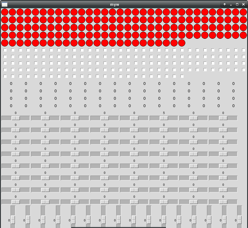

Success must depend on the LCNC version. I have 2.8.4 and tried quick and dirty copy files from github to a new subdir in ~/linuxcnc/configs. I got the new tabs but the widgets appeared in 2 seperate windows ( tabs empty). So to embed pyvcp requires update.
Multiple tabs might fill my needs but scrolling panes inside the tabs would be nice
BTW pyvcp pane can be created by scripts. I dont know is glade qtvcp pyqtvcp can do that.
