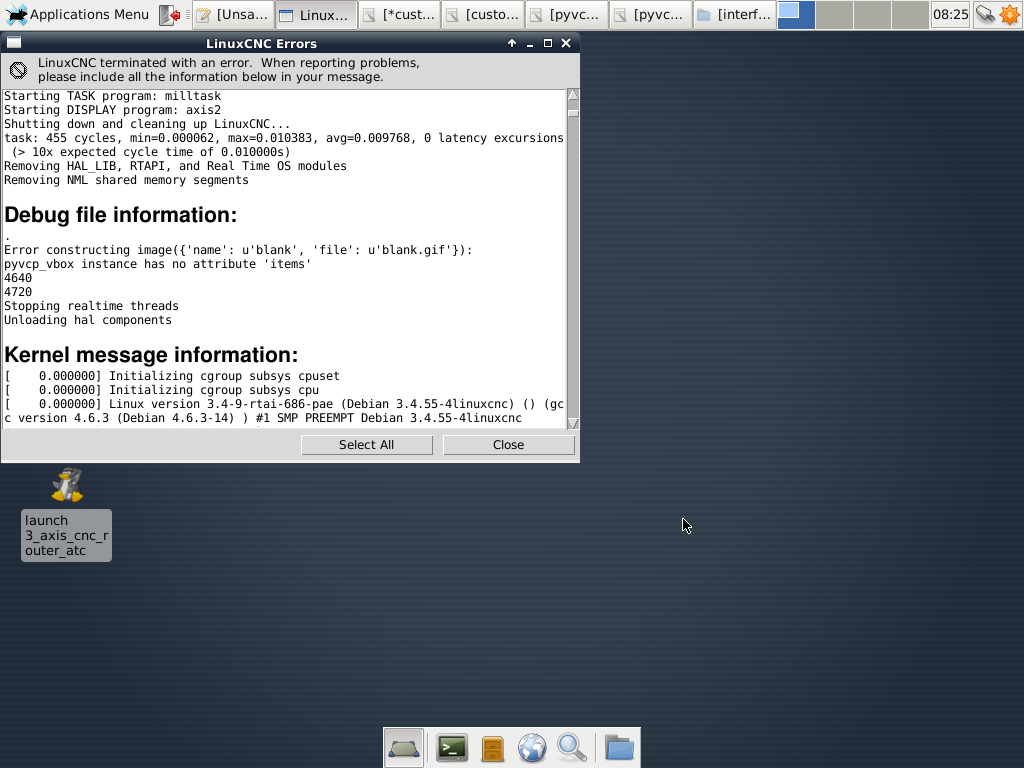

03 Apr 2023 20:31 #268220
by fery15sty
Replied by fery15sty on topic show image in pyvcp widget
I've tried and error like this
