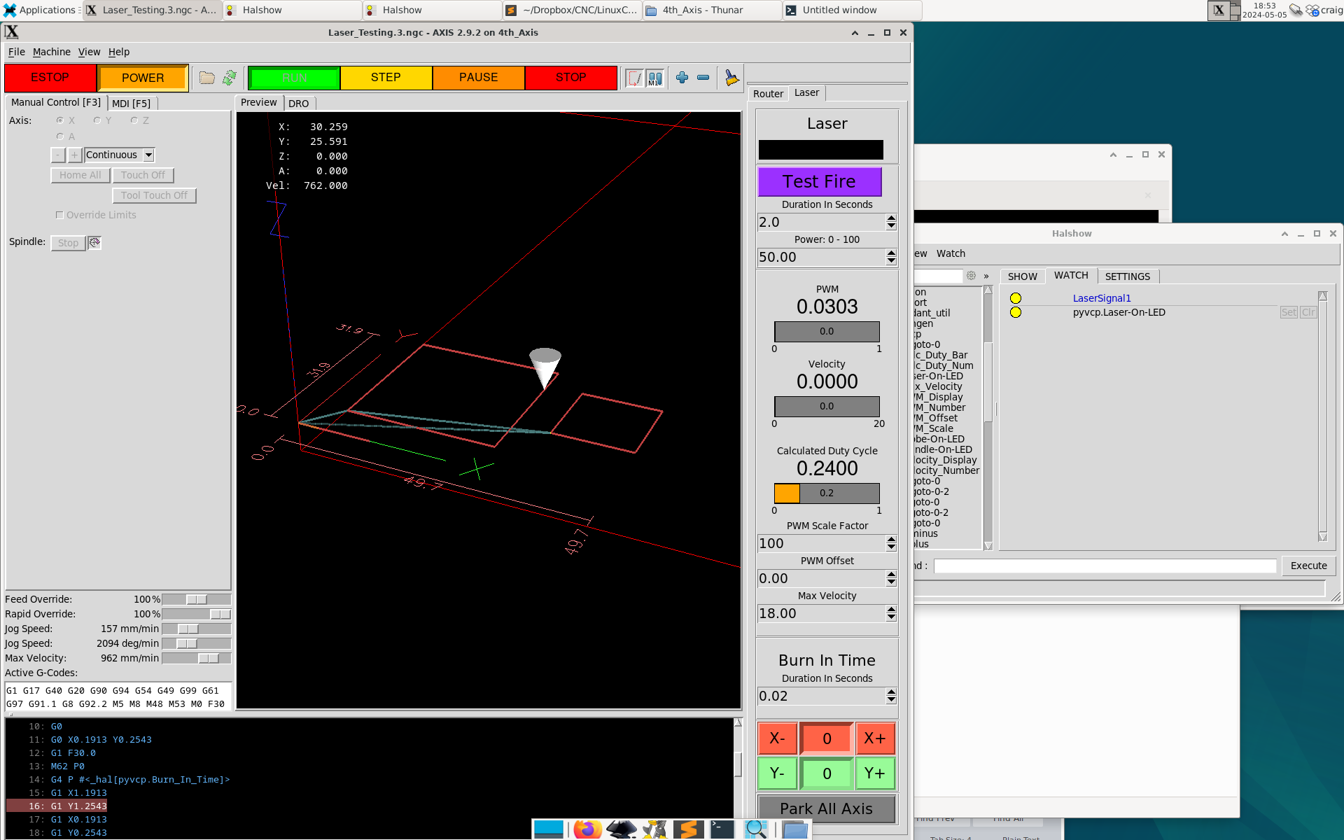

I recently got a new ( used, I still use the parallel port ) computer for LinuxCNC. Rather than clone my old setup I did a fresh install of Debian 12 and LinuxCNC 2.9.2.
I ran the script that auto-updated my config files and compiled / installed my custom HAL components and success! My machine works!
One problem has presented itself. My custom panel in Axis / PYVCP is not updating. I used HALShow to confirm the signals are indeed working under the hood but they are not working in the custom panel. The attached screen shot shows the LaserSignal1 and pyvcp.Laser-On-LED both active while the program runs but the Laser custom panel LED does not "light".
Before I post my HAL files I thought I'd ask if there is any obvious thing I'm missing when upgrading from 2.7 to 2.9. And since the problem seems to be somewhere in Axis / PYVCP I don't know if the HAL files matter anyway as it appears the needed signals are all making their way into Axis.
Any thoughts are much appreciated, thanks in advance,
Craig

One more thing I find confusing;
The "Test Fire" button works as it should. I have it setup in my postgui HAL file like this:
net test-fire halui.mdi-command-34 <= pyvcp.test-fire
But none of the spinboxes are working....

Ok, a little progress. I poked around entering numbers and such and managed to get this error ( attached below ). Once this error shows up I no longer see any updating in HALshow.
I'm not so good with Python but is appears the problem is formatting related;
TypeError: not all arguments converted during string formatting

It occurred to me I did modify the axisrc.py script to customize my Axis GUI.
Maybe I need to update some of the *.tk.* sections? Just guessing here.
axisrc.py attached for reference.

i dont see very much in your usercommand file that would even need updating from python3, and it would complain about it specifically if there was something wrong.
Not sure what you need to update from py2 to py3 for a vcp, but from the error message, it looks like its coming from a/the "bar widget" as far as i can tell, in your pyvcp
