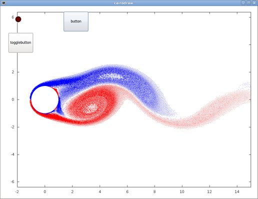

- psha
- Posts: 99
13 May 2011 15:53 - 13 May 2011 15:54 #9782
by psha
Replied by psha on topic Re:Control Gcode program loaded into Axis
It's possible to place controls over image. There was example in emc-user mailing list.
See section 'Animated function diagrams: HAL widgets in a bitmap' in the end of wiki.linuxcnc.org/cgi-bin/emcinfo.pl?HalWidgets
There is link to example code
