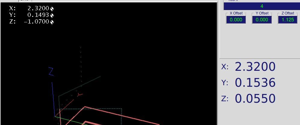

02 Jun 2011 12:06 - 02 Jun 2011 12:29 #10265
by piasdom
Replied by piasdom on topic Re:feed convertion was looking for a combined feed
it switches between relative position and machine position.
i like relative because when i have offset(g10..g55), it show the relative(no offset = 0)
machine position shows the offset(offset = 1.9) and moves from there.
first way - g0 x1 y1 x and y move to 1
second - g0 x1 y1(g54 = 1.9) x moves to 2.9 and y move to 1
in the pic, z is suppose to be at -1.07. in axis that's what shown.
pyvcp panel shows .055. i would like to have a dro as in axis.
if that is possible.

02 Jun 2011 14:35 #10267
by piasdom
also, i changed z from relative to feedback and commanded.
they all show the same. shouldn't they (at least one) be different ?

02 Jun 2011 16:59 #10268
by BigJohnT
Replied by BigJohnT on topic Re:feed convertion was looking for a combined feed
If you have an offset in the current coordinate system yes they will be different.
