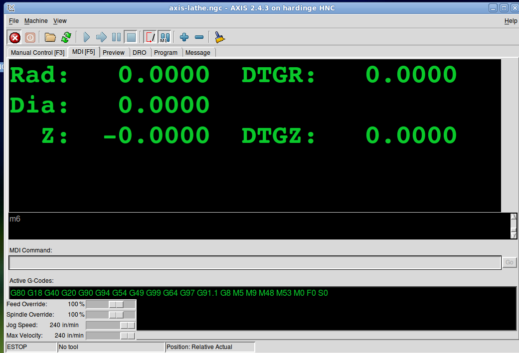

Ive also been playing with the Axis interface,Im still learning the TK/TCL part along with the python.I wanted to have all tabs similar to the way a Fanuc has soft keys,a work in
progress...
Last edit: 25 May 2012 02:27 by JR1050. Reason: bad pic
