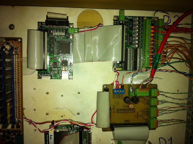

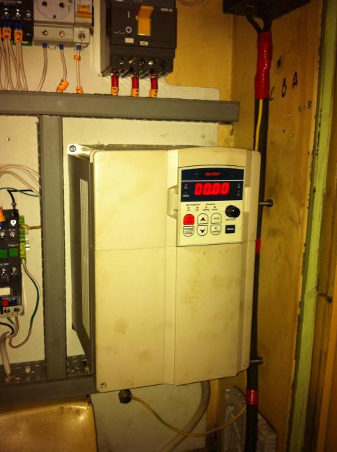

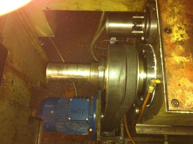

Hi!
I want to make spindle feedback with auto adjust speed using pid.
I use external encoder for 1000 ticks per round, very simple frequency invertor for 11KWt, AC asinchronous motor 10kW and Mesa 7I43 FPGA board.
All these items are in photos below.
Below is the text ini and hal file
The question:
Is PID setting right or not?

31 Aug 2012 09:21 #23793
Replied by andypugh on topic Re:SPINDLE PWB with PID and ENCODER
aike wrote:
Almost certainly not.
Start with PGain IGain DGain all zero and adjust the FF0 Gain until you get the correct speed at one particular speed demand.
Then increase the Igain until the speed settles at the rate you want at other speed requests.
You might want to set the FF0 a little low so that the speed never over-shoots.
Is PID setting write or not?

05 Sep 2012 17:05 #23937
by aike
Replied by aike on topic Re:SPINDLE PWB with PID and ENCODER
I did it.
The video and photo later, but the final result
Pgain = 0
Igain = 0,4
Dgain = 0
FF0 = 0,5
FF1 = 0
FF2 = 0
deadband = 0,01
maxoutput = 0
The stable 99% (unstable of spindle frequency less 1%)
