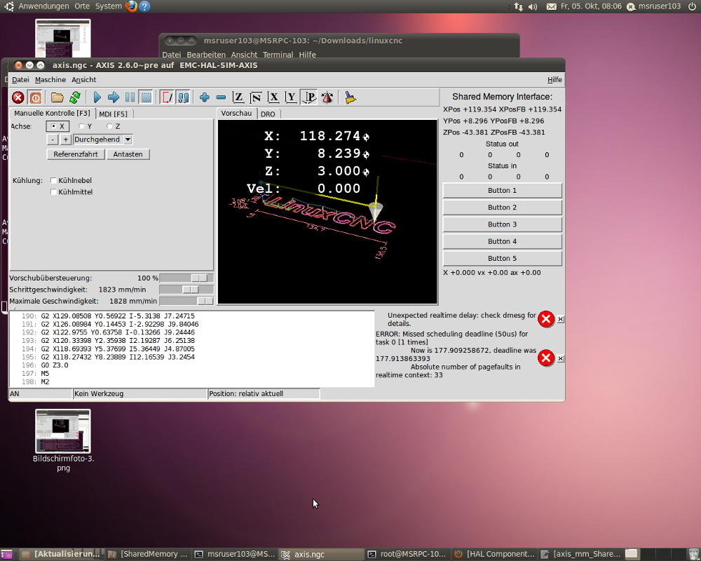

Hey, I'am using LinuxCNC with SharedMemory Patch from Michael Abel with RT_PREEMPT instead of RTAI for real time.
If I start linuxcnc I get the following warning: (see image).
I get in the following Warnings after while in terminal:

Unexpected realtime delay: check dmesg for details.
emcTaskInit: using builtin interpreter
New maximum latency of task 0 is 395 at period 5000 us
ERROR: Missed scheduling deadline (50us) for task 0 [1 times]
	Now is 177.909258672, deadline was 177.913863393
	Absolute number of pagefaults in realtime context: 33
New maximum latency of task 0 is 5050 at period 5000 us
ERROR: Missed scheduling deadline (50us) for task 0 [2 times]
	Now is 177.938913539, deadline was 177.938863393
ERROR: Missed scheduling deadline (50us) for task 0 [3 times]
	Now is 177.939097369, deadline was 177.943863393
ERROR: Missed scheduling deadline (50us) for task 0 [4 times]
	Now is 177.996203097, deadline was 177.998863393
New maximum latency of task 0 is 124503 at period 5000 us
ERROR: Missed scheduling deadline (50us) for task 0 [5 times]
	Now is 178.738367328, deadline was 178.618863393
ERROR: Missed scheduling deadline (50us) for task 0 [6 times]
	Now is 178.738517424, deadline was 178.623863393
ERROR: Missed scheduling deadline (50us) for task 0 [7 times]
	Now is 178.738599561, deadline was 178.628863393
ERROR: Missed scheduling deadline (50us) for task 0 [8 times]
	Now is 178.738720322, deadline was 178.633863393
ERROR: Missed scheduling deadline (50us) for task 0 [9 times]
	Now is 178.738793169, deadline was 178.638863393

I set the time from 50us to 50000us but it doesn't work too.
What is my problem?
I checked real time with cyclictest- the system supports real time.
05 Oct 2012 09:38 #24968 by andypugh
Don't be surprised if you don't get any answers to this. I don't know how many people are trying to use RT-PREEMPT and it is very experimental.
If you actually want to make parts rather than be part of the task to develop RT-PREEMPT then the normal (RTAI) installation is definitely the way to go.
