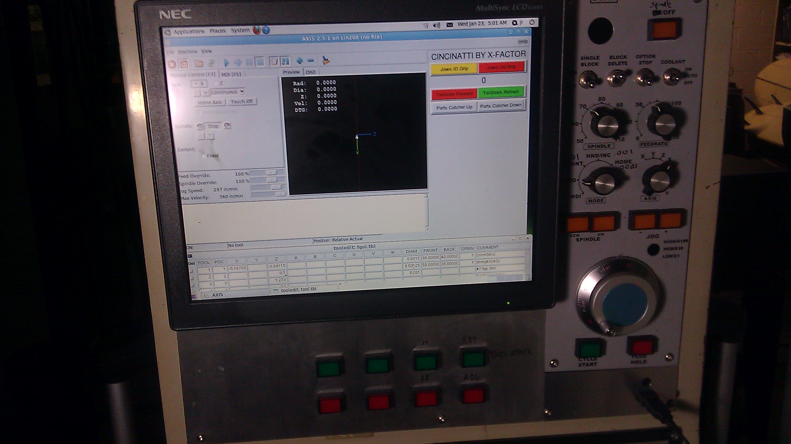

Hello,
I have built a more typical user control panel consisting of regular buttons,knobs and switches.It is wired to a Mesa 7i84 board.The board works very well.I have written a component in C to read the states of the inputs and set logic,it also works so far. My problem is that there seems to be a fight with the Halui pins and the same actions in the Axis Gui.Example,I have a physical cycle start button,a bcd mode selector and a feed hold button.If I load a program and put the selector in auto mode then hit cycle start,it will run,if I hit feed hold,it will pause ,then cycle start,it will resume.So far so good,if I hit the program stop button on the gui,the program stops but it will not run again from the button,only from the gui.
It seems as though Halui and axis are sharing the same base commands,can theses be addressed directly(no halui).I opened up the python axis file and had a look. If axis and my panel wont play nice,would eliminating the gui buttons solve the problem? Halui info seems scarce,any suggestions.Thanks as alaways.

Attached is my noncompiled component for the panel.I am using the is-auto and is -paused,ect states.It wont do anything without them.Ill look into toggle2nist. I have no idea what it does!!!Im also gonna look at the header files. Thanks again,for the record,I didnt build the panel with all the buttons ect,It was made bt delta tau data systems,I just rewired it.I am how ever going to make a very similar panel for the rest of my equipment as soon as i get this code thing ironed out.

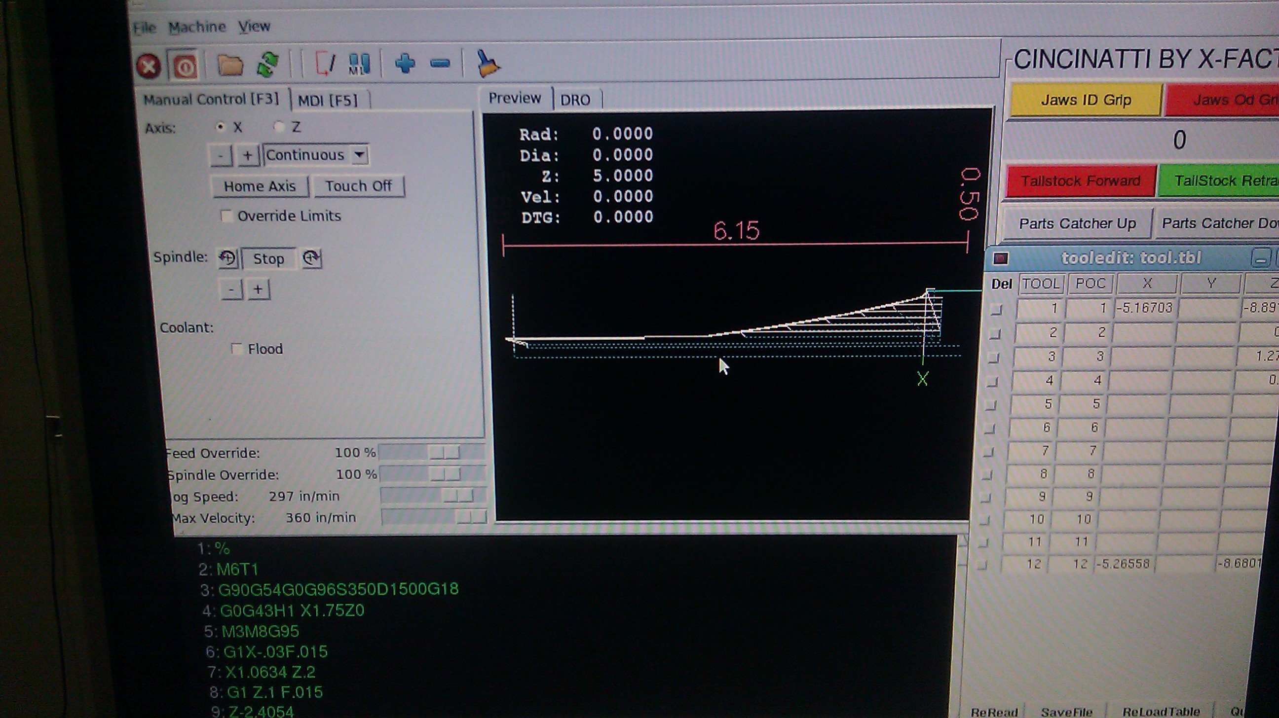

28 Jan 2013 11:35 #29216
by JR1050
Replied by JR1050 on topic Axis and Halui are not playing nice...
After looking at both the halui source , toggle 2nist and some trial and error I came to the following observations;
Toggle2nist is a component that works best on the hal layer,it doesnt offer anything that cant be more simply coded in a component. I dont do logic on hal,it is solely for connections.
The stop program button on the gui also fires a reset/abort signal . I added physical reset button that both stops a program and/or rests and aborts errors. This required using halui.program.stop and halui.abort.
After adding the code to my component and adding the button I can now run a program, pause,stop and reset the control,which then allows me to rerun the program from the physical buttons.I spent some time in the axis.tcl file and commented out the gui buttons which are now physical buttons.I also changed some colors and fonts.
Presently working on the single step switch....picture of the slightly modified gui,for anyone interested.
